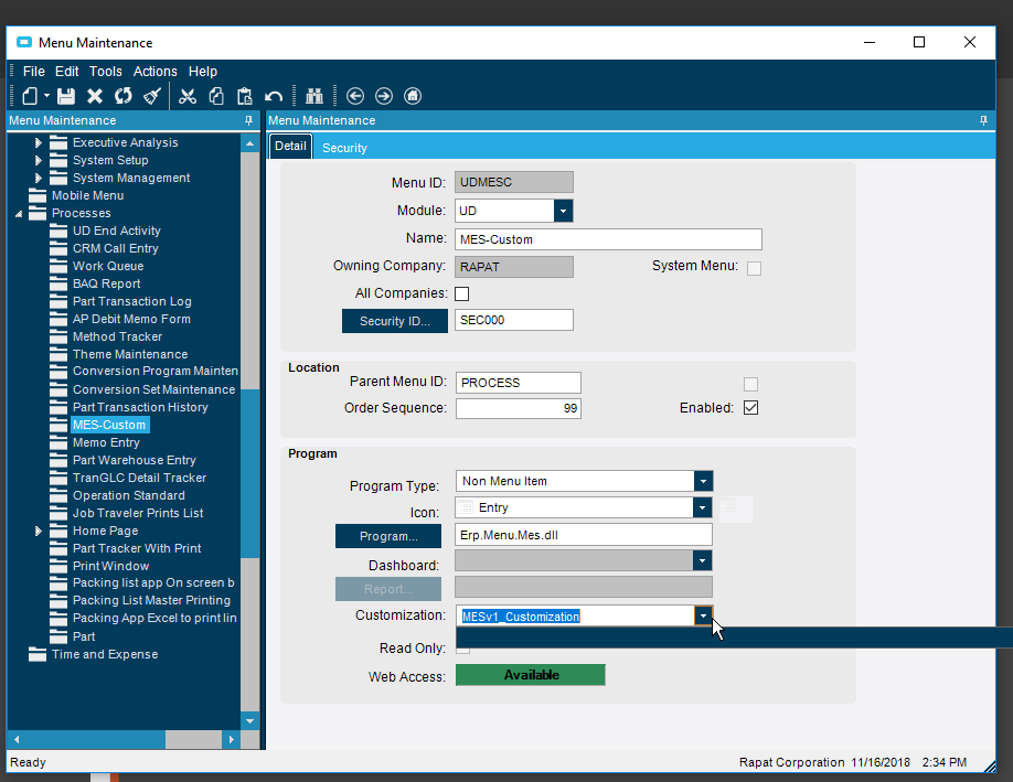

So I am working on an next version of our MES customization, so I saved a copy and now am trying to deploy in in pilot, but only the original customization that we had will show up. I tried our company since that’s what the current menu item is, and all companies. Neither of them will show up. Has anyone else had problems with this?
Are you working with a different version of Epicor in Pilot than you are when you created the first MESv1 Customization? Does it have something to do with the Program selected in Menu Maintenance? The “Erp.Menu.Mes.dll” ?
The first version of the customization was created in 10.0, we are now in 10.2. It’s come through on the upgrade. That’s interesting on the program selection. I see that when I search MES, that one doesn’t show.
So if I change that, they still don’t come in… and now MES goes back to default. How do I get that fixed?

I can open them in developer mode (they are still there), so I can still get to them. But none of them show up in the menu maintenance to actually deploy them. Not a big deal in Pilot (that’s why I mess around in Pilot right?) but I imagine I will have the same problem when I try to do the same thing when I need to import the new customization into production. Worst case I just have to work under the same customization instead of making a new version. (I know, bad practice…)

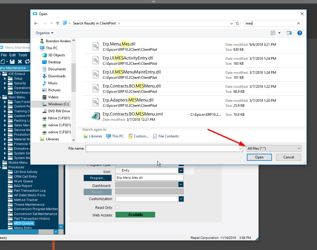

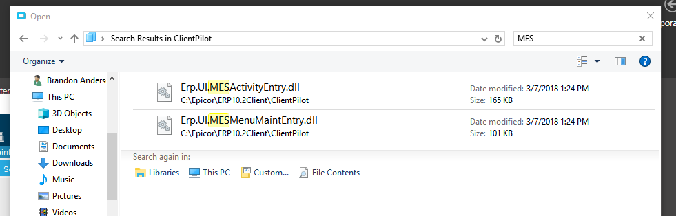

Can anyone tell my which program I am supposed to pick for this? Erp.UI.MESMenuMaintEntry.dll or Erp.UI.MESActivityEntry.dll ?? It seems like both are working (for the base form anyways)

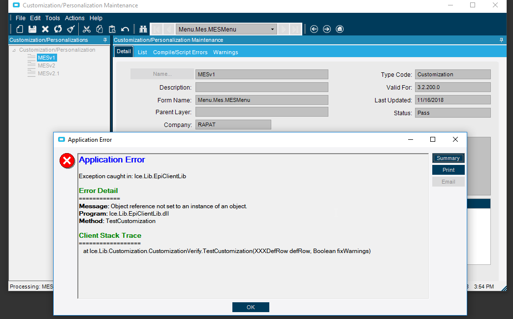

Yes, thank goodness for test environments. That is just very strange that the upgrade wouldn’t apply your original MES customization to the new .dll Program and it would keep the older Program name. It’s just interesting that you had that old Program name in there from 10.0 but you could still see the original Customization when you opened MES in 10.2? You can’t run those things through the Customization Verification process can you? :thinking:
I just tried that and it gives me an error. Interesting that they all show up there though.
This is for the base MES screen right, if so, neither of those DLLs are what you need. You need the Menu.MES as it shows in the calling msg box. I dont know if its related, but I have seen similar issues where from certain versions the base form name has changed. This means your original custom will have to have this name changed in the XML probably.
Alright, I found it again, I have to select “all files” to get to it. (annoying) but ok.
None of the customizations show up though. Not the original, not the copies, nothing.

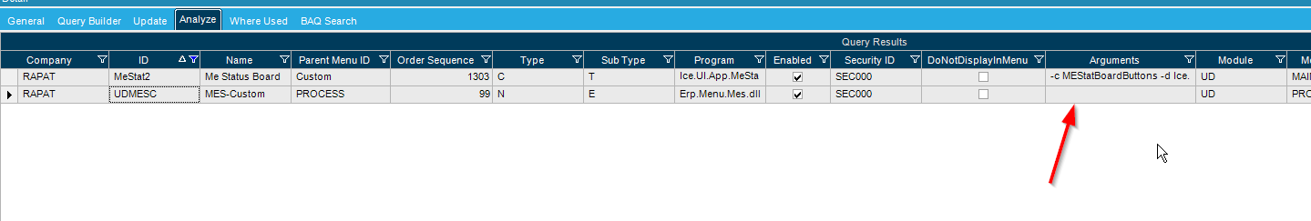

I had to write a UBAQ to set the arguments for the menu item in a case like this. Because the form name changed, and they didnt update the filter, customs for it wont show. You can look at the format for setting a custom on a menu item, i am pretty sure its just -c custom name

Because the menu maint screen isnt listing your customizations, you can force the menu arguments.
When you set a custom on a menu item, it sets arguments = -c CustomName
So you set that in the UBAQ, there’s nothing that you can do to make it allow you to choose what’s actually there. Gotcha. Let’s see if I can make this work.
That was the ticket.
For those of you that are interested, you make a UBAQ on the the table Ice.Menu. Make Arguments updateable. Then you can type in -c YourCustomizationNameHere . This will force set the customization instead of using the drop down.
Here’s the Ubaq if you are on 10.2.200 or later.
