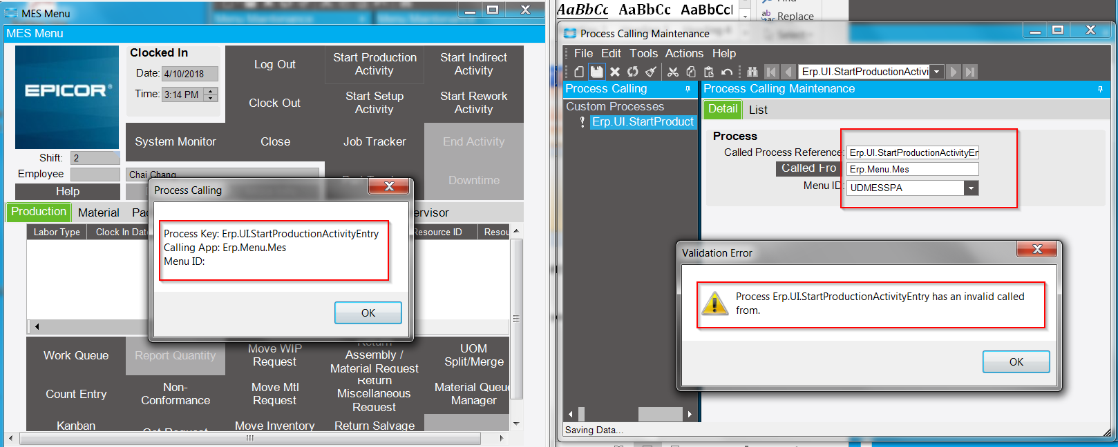

So I followed the above. I went and created my Menu Maintenance and now going into Process Calling Maintenance. When I add in the process and calling app entry, I get the error when saving. Any ideas?
So I modified “Start Production Activity”. When I click on that I get the pop-up with “Process Key” and “Calling App”. I entered this information when in “Process Calling Maintenance”. However, I am getting error that “Process Erp.UI.StartProductionActivityEntry has an invalid called from.” Is there a different “Called From” that I should be selecting?
I tried doing the below which allowed me to save. However, it is not displaying my customized program when I log into MES.
Try using that called From button to search. It def needs to be MES though (not what you put in the last pic)

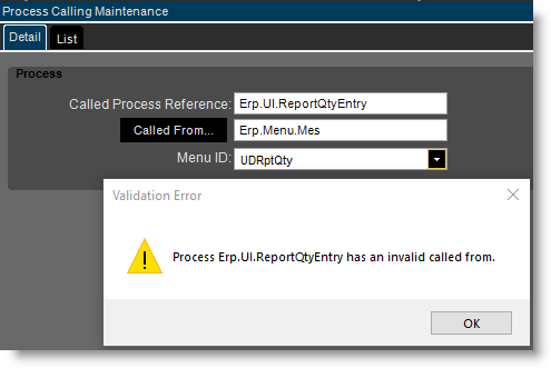

I am having this same issue.
Erp.Menu.Mes is not valid anymore for some reason. This is the value that I had in several Process Calling Maintenance items before and went to add a new customization today and all previous entries were flagged as invalid.
I checked our test environment and the same values exist and the customizations work.
Version 10.2.100.13
It seems to work if I leave the “Called From…” field blank.
