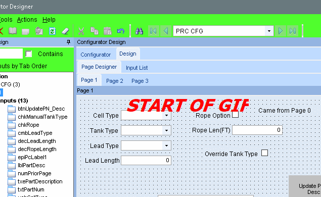

You can do it by:
- Add a numeric control named
numPriorPageto page 1.
Set it’s initial value to 0 - Add a label
lblCameFromto page 1. This is just to display the prior page. - Add the following code to page 1’s OnLoad:
Inputs.lblCameFrom.Label = "Came from page " + Inputs.numPriorPage.Value.ToString() ;
Inputs.numPriorPage.Value = 1;
- Add a label
lblCameFrom2to page 2. This is just to display the prior page. - Add the following code to page 2’s OnLoad:
Inputs.lblCameFrom2.Label = "Came from page " + Inputs.numPriorPage.Value.ToString() ;
Inputs.numPriorPage.Value = 2;
- Add a label
lblCameFrom3to page 2. This is just to display the prior page. - Add the following code to page 3’s OnLoad:
Inputs.lblCameFrom3.Label = "Came from page " + Inputs.numPriorPage.Value.ToString() ;
Inputs.numPriorPage.Value = 3;
It even detects jumping pages!
