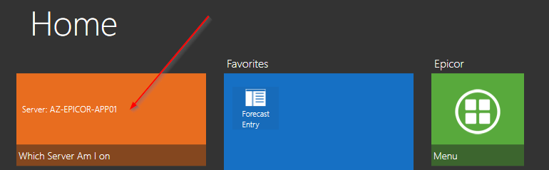

@josecgomez created a BAQ that simply returned the server instance and then added that BAQ as a Widget.
Perhaps it returned User Session or something, maybe he can elaborate.
Is just a UBAQ with a PostProcessing on GeList() and a Calculated field
foreach(var x in ttResults)
    x.Calculated_Server = Environment.MachineName;
