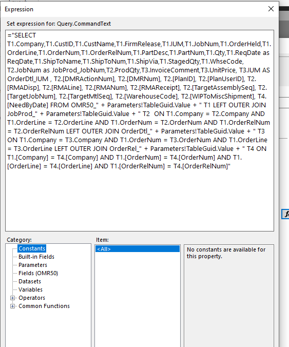

I can follow what you are suggesting I do all the way to editing the expression. Not sure what to do here. My RDD looks like this…where I’m joining the job number and company.
And my expression on Dataset OMR50 looks like this… What am I to enter to edit?
Here is an example of SchedShip (E10.1.6) where I added JobHead JOINED to JobProd in the RDD.
Then in SSRS edited the query - where T3 = JobHead. Note it can take a couple tries that first time. I usually copy the query statement to an external editor too (as the built in editor in kind of sucks…like just about everything in SSRS). Also - remember to keep track of your comma’s and quote marks - that’s where mistakes typically creep in.

and finally… remember to add the new fields.
I guess I didn’t do very well.
I’m trying to add the field you see in the Job Header called Due. It’s based on when it estimates you can ship product after the final op is done. I see that in the report that same field title is listed as a parameter. Is this were the error message is coming from?
Tried changing to use the field LastScheduledate and got the same error. UGH!
I tried starting all over from scratch and trying to duplicate what you have. When I look at the dataset expression to edit the query, mine looks different than what you’ve attached here. I have a T4 in my query. So does that automatically make the JobHead T5? Should I see my added fields in the query?
Yes, the query I posted was just an example were the unmodified expression ended at T2 - so the table I added then had to use T3.
So… if your unmodified expression ends with T4
  • and you added JobHead to your RDD
  • then you would add JobHead starting at T5 in your modified expression
  • which will include any JobHead fields - e.g. T5.ProjectID
  • AND then the “T5” table joins at the bottom
  • also, once your expression is working, you still have to any field to the DataSet Properties - Fields sheet.

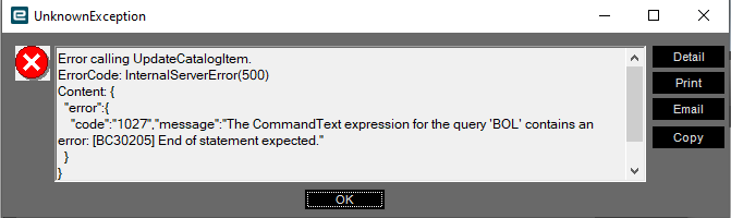

Similar spot as the OP. Cannot for the life of me understand how this statement is incorrect.
="SELECT CAST(T1.BOLNum AS NVARCHAR) AS BOLNum

The Shiphead table is already in the BOL RDD, and I’m just trying to access the PackNum to show each packer sent on a BOL. All I’ve done is set up a relationship between BOLDetail and Shiphead joining on company and BOLNum, then activated the PackNum column in the RDD, and added T3 to this SQL expression. :man_facepalming:
Disregard, there was absolutely an extra quotation mark in that statement :slight_smile:
