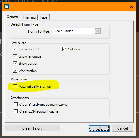

If you look at the preferences when you login there is a section under My account, that says Automatically sign on. We noticed some users are using this feature, and we don’t want them to. Can this feature be disabled at the company or site level? If so, how?
Thank you!
Nate

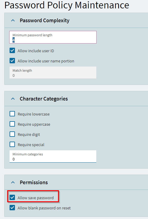

Uncheck ‘Allow save password’ in Password Policy Maintenance. That’ll disable the automatically sign on box.
