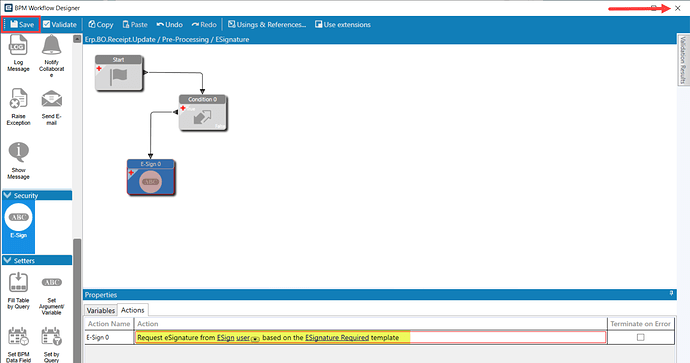

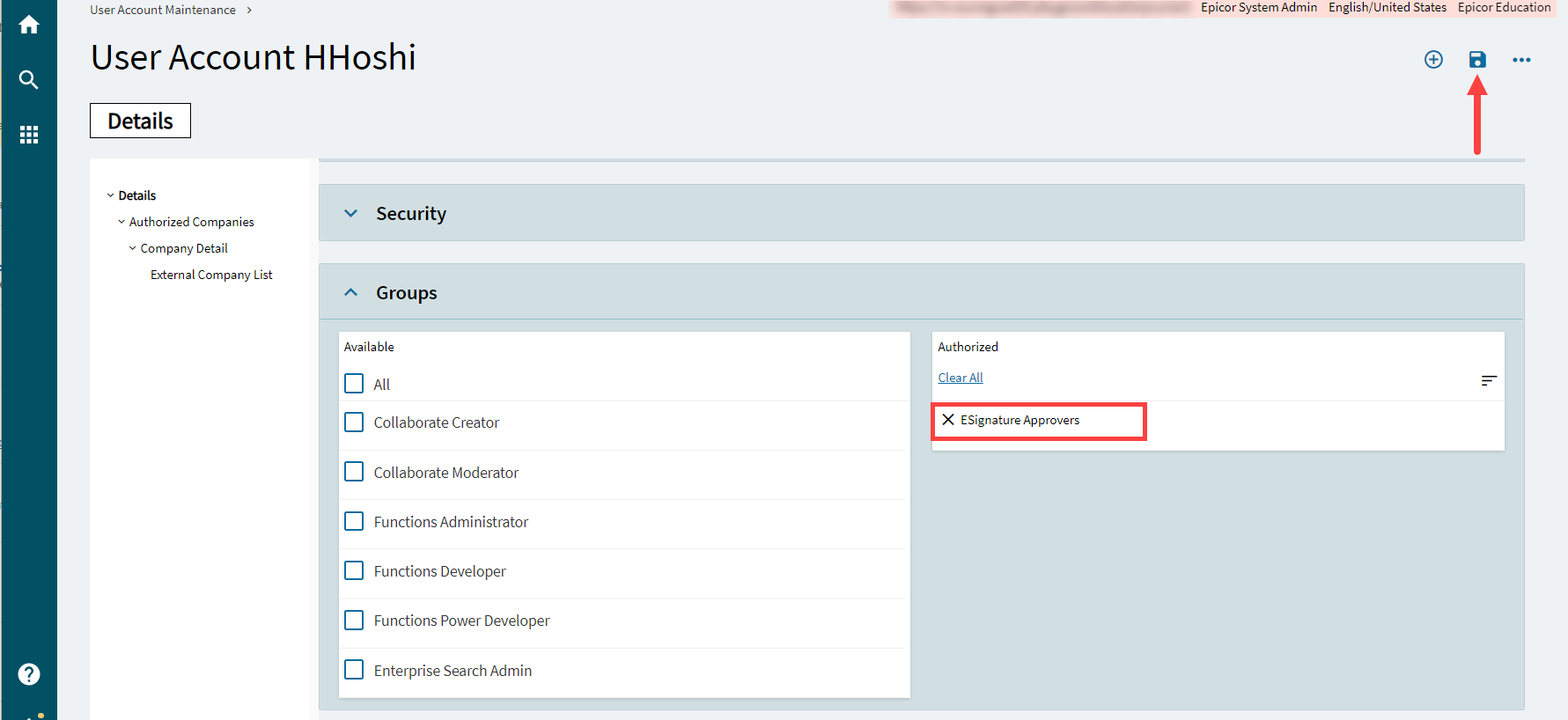

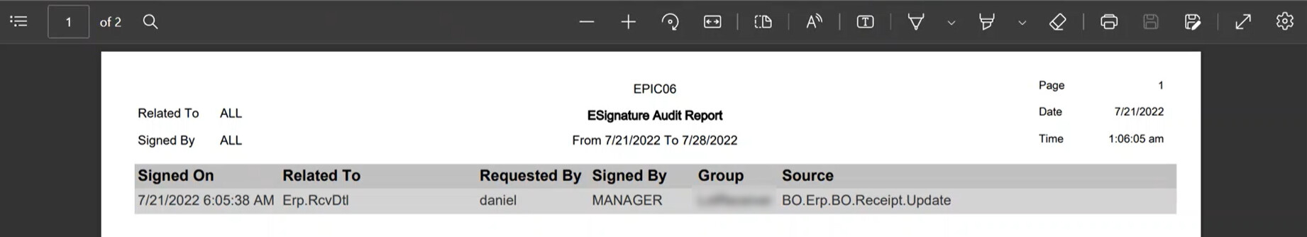

Indicate which individuals can electronically sign records within User Account Security Maintenance. Then create Business Process Management (BPM) Method directives that require ESignatures when users update specific records, such as receipts. Then run the ESignature Audit Report to review the electronic signatures entered into the system.

Basically once you save it will require you to Login again to confirm its your with a Password, once you do that you have “Electronically Signed it” and it shows up in an Audit Log.

I checked in live Kinetic in browser. I don’t see a group called ESignatureApprovers. Do I need to create the group?
I think you just create perhaps any group. But also this is only in 2022.2.
I am on 2022.2.3 in live now. If I create that group, will the sign-off functionality be attached to it automatically?

I was able to use that documentation to setup a basic esignature system. This proof of concept shows it is possible. I have a few places I would like to use this feature. I’ll make a new post later on when I get it up and running. I am nervous to use this feature as I am not sure how stable it is.

Ohhh! All great questions, Calvin! I am not sure I am the person to answer, but in my testing I put the esignature widget on a method, and when the method fires, the standard epicor user/pass dialog pops up. I believe that this requires the current user to reauthenticate. I am not sure if this could be used to authenticate another user. I will post back as I learn more. I am curious if other folks use this feature.
