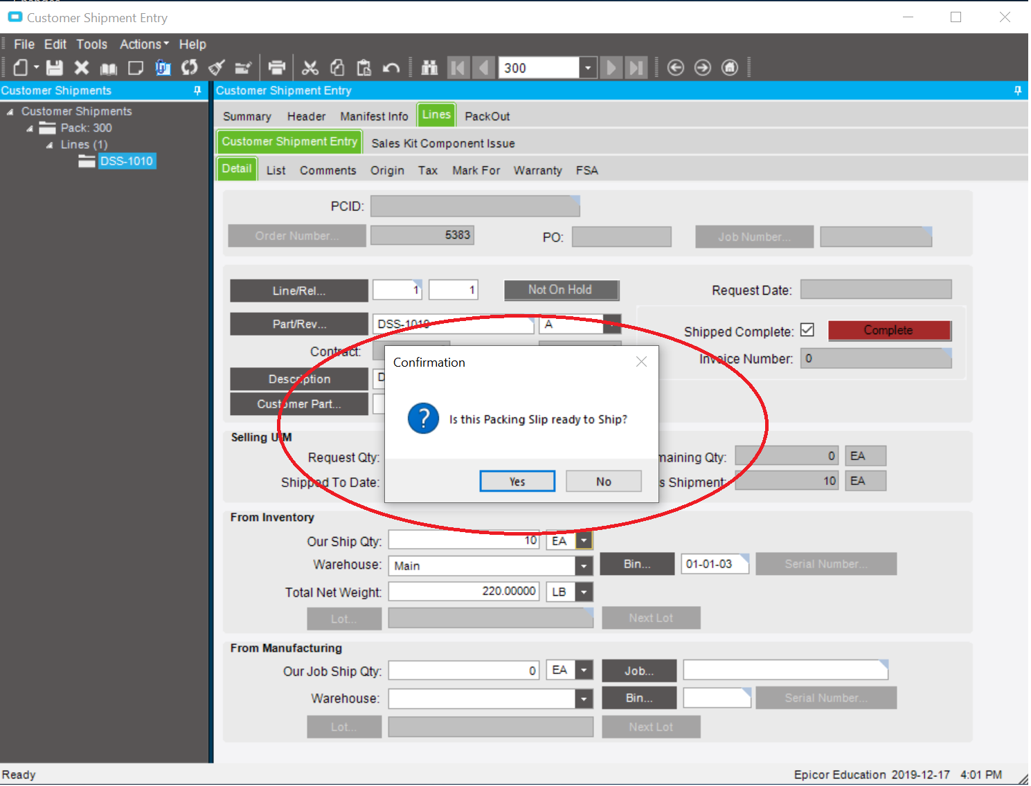

Disabling Prompt "Is this Packing Slip Ready to Ship"
Hi all,
Good day!
Is there anyway we can somehow disable this prompt after printing the packing slip?
We normally don’t ship items after printing the packing slip.
Thanks,
Chemuel

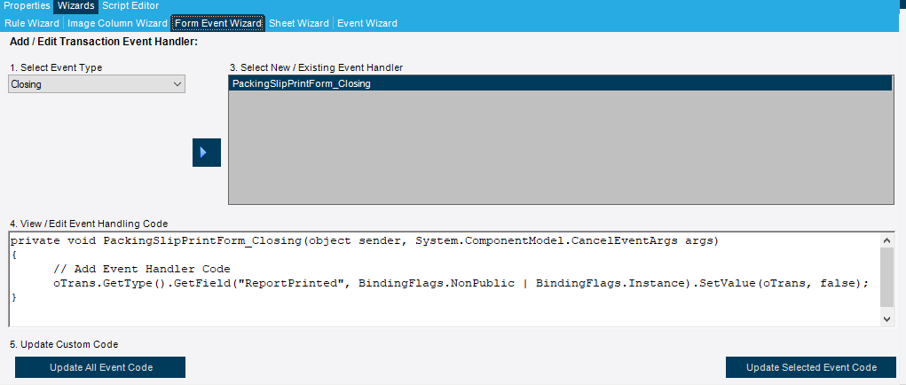

You need to customize the Print Packing Slip form, using the Form Event Wizard on the Closing event:
Hi Brian,
Merry Christmas.
I found some minor errors when executing this.
Not sure how to fix the binding flags error.
It’s all good Brian,
I had to add using system Reflections and it work as desired.
Thanks a lot.
Great topic - We just got the request to do this. I added the code, included “using System.Reflection;” in the top. It compiled with no errors, but I still get the pop-up on closing. I’ve restarted and cleared cache, but still not suppressing the pop-up. I added a label box to the UI so I know my customization is being called.
@bmgarver - How did you know to try that code in the first place? Could something have changed between 10.2.300 & 10.2.700?

		oTrans.GetType().GetField("ReportPrinted", BindingFlags.NonPublic | BindingFlags.Instance).SetValue(oTrans, false);

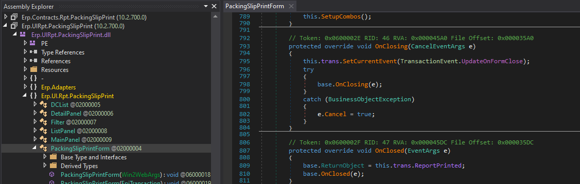

My trial and error method isn’t working - Downloaded dnSpy, opened the Erp.UIRpt.PackingSlipPrint.dll
and found ‘OnClosing’ and ‘OnClosed’ derived type. The UI wizard has a “closing” dropdown, but not “closed”
Any suggestions on my next step? Trace doesn’t show anything, and what worked in the UI in the earlier version doesn’t in 10.2.700 (expertly copied from @bmgarver) @Chris_Conn @Banderson @hkeric.wci @josecgomez ?
