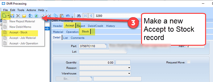

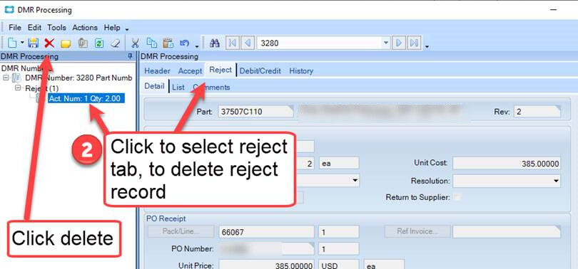

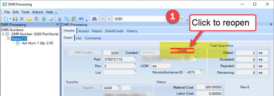

Hi Kimberley,
We have had luck with steps below to back it out and re’receive it. Can this work for you?
Nancy
