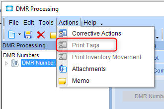

Wondering if this have to do something with company configuration to turn it on? No matter what I choose Closed or Open DMR the Print Tags show greyed out.
Hello,
Print Tags should light up once you have Accepted or Rejected a Qty on the DMR.
We had the same question but our Quality Director found a workaround. There IS a way to print tags that have zero Qty accepted/rejected:
Nonconformance => Search => Search by Part Number => Look for latest transaction referencing RMA xxxx => Select that line and go to Action => Print Tags.
