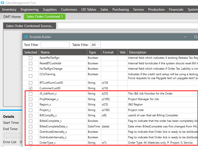

Is there a way to DMT data into custom fields? For example the ones created on the PartPlant_UD table.
thanks
Yes. just the way you would any other field. In fact, the Template builder will display your UD Fields too.
edit
here’s the Sales Order Combined template window. See how it shows my UD Fields?
(It even shows the description that was entered in UD Ext Column maintenance)
thanks I completely looked right over it. :slight_smile:
