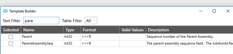

But after looking at the field help, I wonder if there isn’t something extra going on to get those to change.
Yes I’ve just spent the last hour using the ParentAssemblySeq field in DMT which does seem to make a difference but doesn’t give the structure that it does when manually entering. Just trashing my job now to start again.

I noticed this in the DMT stuff. I’ve never seen it before, but I’ve never had to. Maybe this needs to be set correctly?
Eeek weird. This would mean I would need to bring in each level individually and then at the same time as bringing in the subassembly, change the parent to have the child…
yeah, that seems like a pain. It’s supposed to be maintained by the program, but I’m thinking DMT doesn’t get the right treatment. There still should be a way to make this work…
