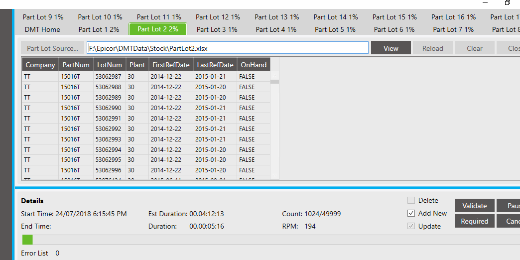

Multii-threading DMT in action
The real question is will it really take 1/17th of the time? When I tried the single file it was going to take about 13hrs… Yikes!.
It usually starts to slow down once you get so many tabs going. I think it’s about 6 or 8 for us, but I would guess it depends on your server setup.

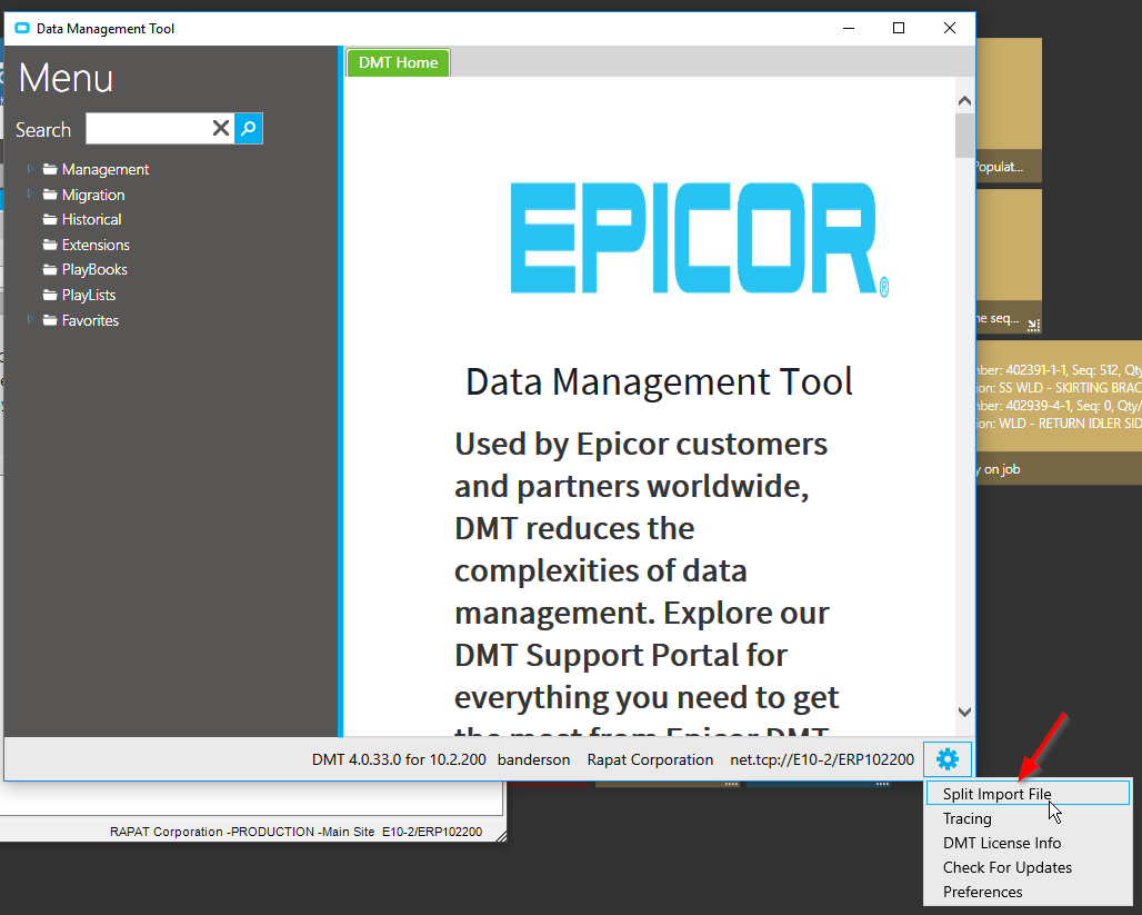

I’m assuming that you found the tool to split the file for you?
splitting files is not something I do on a regular basis and this was a test, so I rolled it myself. I’ll probably use powershell for the final solution. Feel free to post your suggested tool, it will always help someone perusing the posts in future.
It’s right down in the corner, you just tell it which file to split and how many files you want. It takes the file name and duplicates it with a 1 2 3 etc, on the end in the same folder the original file it. It works pretty slick and saves a lot of time.
WOW! and Thanks.
There you go, pays to read the documentation a bit more clearly. Thanks that’t the tip of the week. @edge had a hand in that handy feature no doubt.

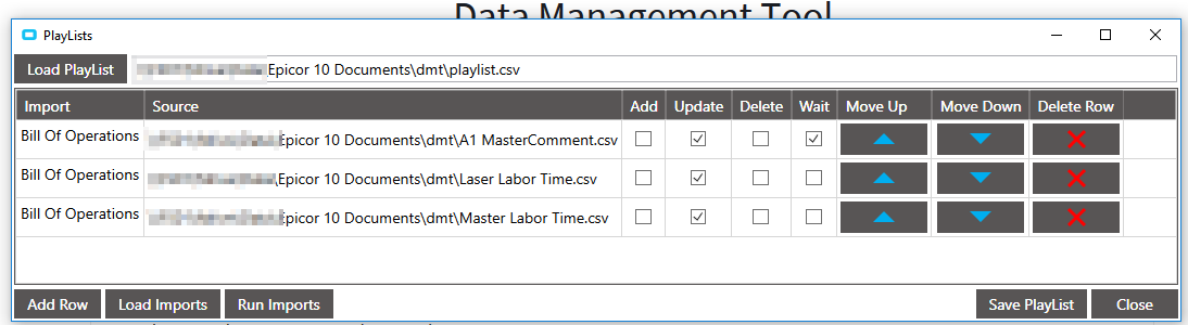

and if you have to do it a lot, you can set up playlists to load all of the tabs for you. If you always split to say 10 files, you can make a play list to load and play those 10 files.
I used the playlist for that test. I actually create the playlist with 1 row, then edited the CSV file. Would have been nice to have a copy row button…Hmmm there’s another one for the enhancements list
Just for some geekiness. All imports started within 15 minutes of each other. Compared from the estimate of the single file 12 hrs or so, a big time saving.
File | hours | min | rpm | rows |
1 | 4 | 10 | 200 | 49999 |
2 | 4 | 11 | 199 | 49999 |
3 | 4 | 13 | 197 | 49998 |
4 | 4 | 9 | 201 | 49999 |
5 | 4 | 13 | 197 | 49999 |
6 | 4 | 14 | 197 | 49999 |
7 | 4 | 9 | 201 | 49999 |
8 | 4 | 13 | 198 | 49999 |
9 | 4 | 12 | 199 | 49999 |
10 | 4 | 13 | 197 | 49999 |
11 | 4 | 11 | 199 | 49999 |
12 | 4 | 13 | 197 | 49999 |
13 | 4 | 11 | 199 | 49999 |
14 | 4 | 12 | 198 | 49999 |
15 | 4 | 12 | 199 | 50000 |
16 | 4 | 12 | 198 | 49999 |
17 | 2 | 23 | 190 | 27185 |
OK… so now back to the original question… what is the maximum number of rows?.. It really doesn’t matter because large files are just not that practical. It is always better to do this in small chunks.
