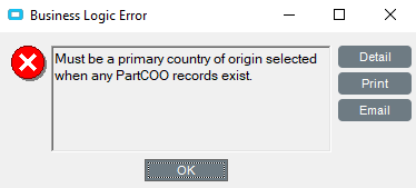

If you go into Part Entry, and try to blank out the Country of Origin field, you get the following error:
You can go into the Reporting->Country of Origin and delete that record, which then makes the Country Of Origin on the Part->Detail sheet “None Selected”
I think you can blank out the Schedule B Code field, but trying to do both is probably failing on every record because of the PartCOO.
You will probably have to run DMT twice.
  1. Update Part with SchedBCode blanked out.
  2. Delete Part Country Of Origin records (Company, PartNum, OrigCountry)
Try this in a test first.
