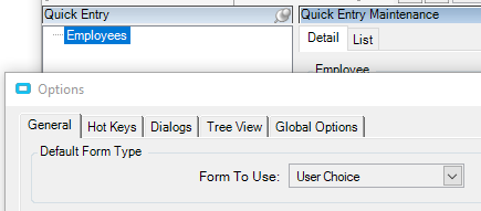

@fakhruddin, thank you. Is it the “Form to Use” option? It is grayed out and set to “User Choice”. Same thing in Tools > Options in the form.
