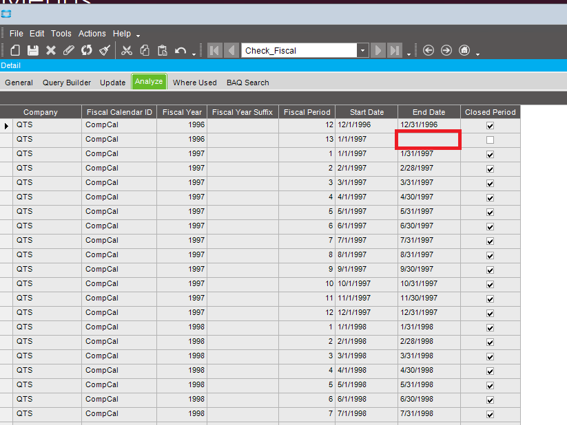

Hello all,
We have a past fiscal period without an end date and it seems to be keeping us from rolling balances properly. Epicor has a suggested SQL fix but I was curious if this could be handled by DMT?? Can I DMT this end date into the system? If so, what table would I be acting on within DMT setting?

They gave us a fix through the data fix workbench. I’m about to run it in our test enviro and see if it resolves issue. Thank you for feedback.
