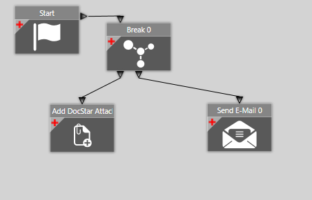

To accomplish the change, I’ve created a custom report style with break & routing that does the two things I need:

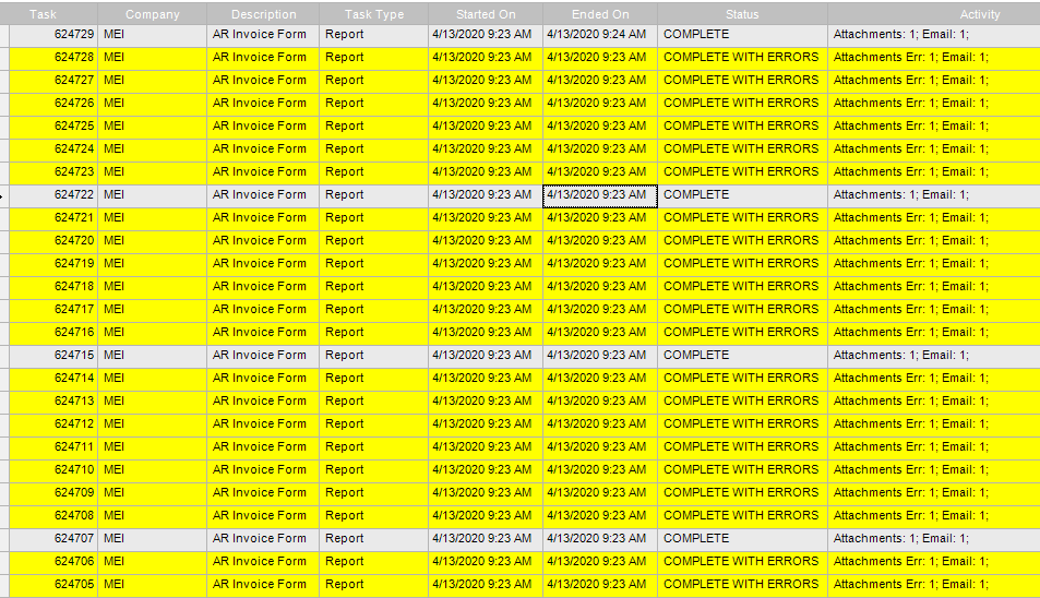

So now I’m at another stumbling block. I ran a test of a very small sample of invoices (25) and it appears that DocStar is having issues with attaching the documents due to deadlocks.
In reviewing the event log on the server, for each attachment that failed, I see the following in the event log:
System.Data.SqlClient.SqlException (0x80131904): Transaction (Process ID 603) was deadlocked on lock resources with another process and has been chosen as the deadlock victim. Rerun the transaction.
