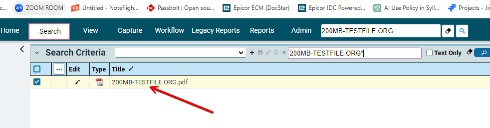

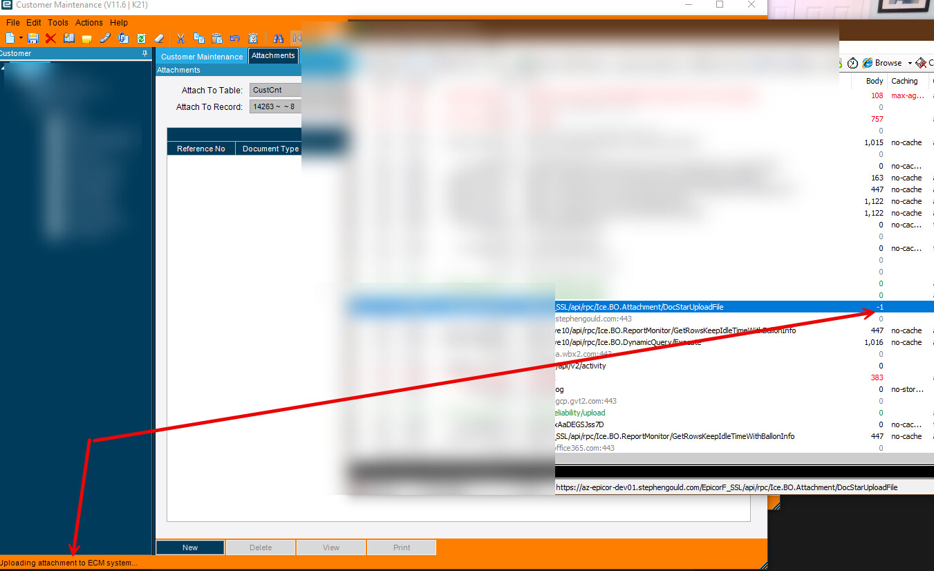

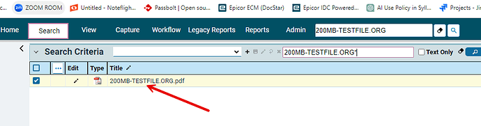

Tried it in classic client with a 200MB file and it didn’t appreciate it much.
But after much waiting the record made it to DocStar just fine
Meta Data, Rendering and all

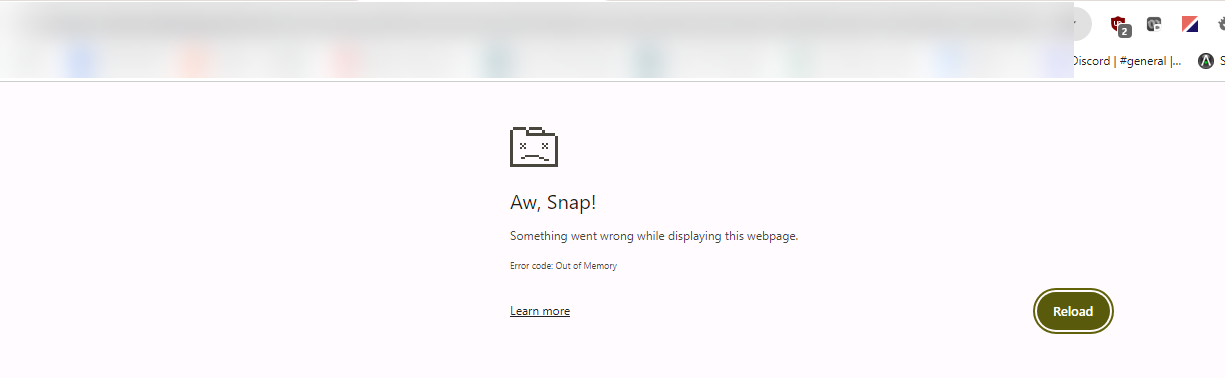

No I didn’t try through the web browser, just classic client… I’ll try the web browser next I guess… Wish me luck
Might as well get used to it. :cry:
I’m fine with browser it allows a tailored UX without the need for business/system logic which SHOULD all be on the server :slight_smile: Design transition is awesome IMO just the UX needs work still, but from what I am seeing is VASTLY better from initial Kinetic design in 10.2.500 ish I think…
Well let’s just say the browser didn’t appreciate it much
