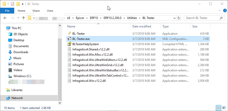

I’m not sure how to get access to BLTester. A cursor search of the filesystem on the server doesn’t yield any results. Any pointers on where to look?
On the app server, it should exist under the Utilities folder of the install.
This is great, but I have no idea what parameters to pass - as opposed to the actual screen where there are fields that at least let me easily guess something. :slight_smile:
Yeah you’ll still need to fiddle around with it to make it work, but sometimes that’s easier than trying to track down the UI form + specific action needed to invoke that method
