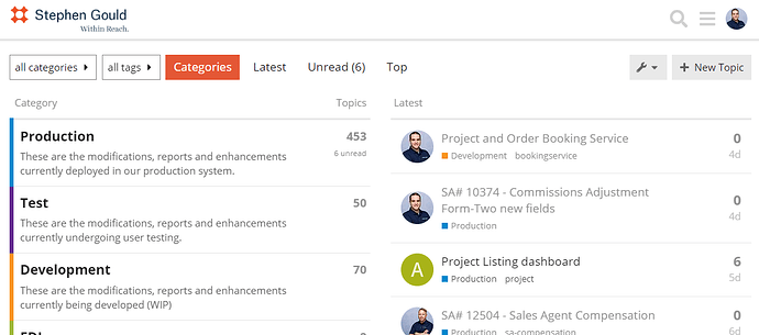

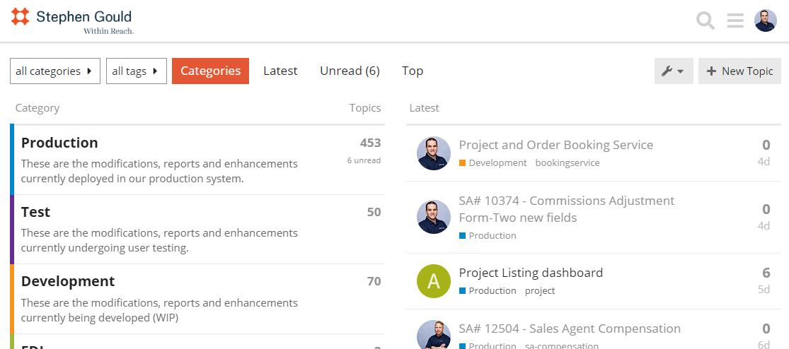

We have a documentation system we maintain alongside Epicor you can use something like Confluence or Sharepoint, or even Discourse Site

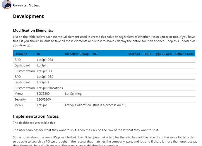

Just record what you did, why you did it, how you did it and any components that make up that solution. Hopefully using something searchable.
I kid you not we use discourse
Each post is a new / update and we track components and implementation notes etc. @jgiese.wci does similarly with Confluence

This right here is a huge mistake IMO, take the time to set-up something and keep it up to date just add documentation time to your development time make it so, force otherwise you will find yourself in a never ending hole of debt that you will not be able to get out of.
I basically force our dev team to keep the documentation up to date as you do it. Added a new field? go update docs… Created a customization? Go update docs.

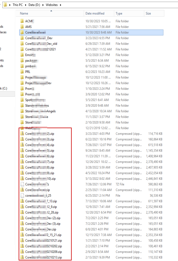

We just inherited a nightmare of a system from a differetn company we aquired and when I asked for documentation I was told “We never had time”
This is the file structure of the server I just logged in to, zero documentation and by the looks of it their Repository System consisted of adding a number at the end of a zip file every few days?

Save your future self and fix it now :slight_smile:
