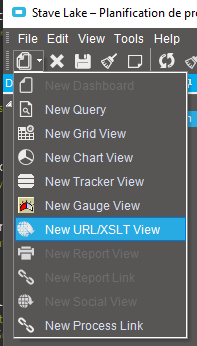

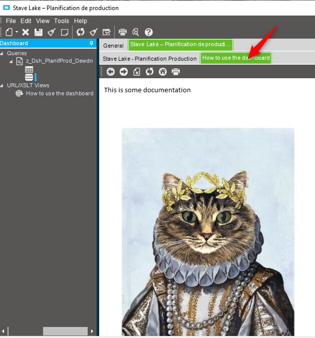

If you want to get funky on a friday evening :
1- Create a MS Word file for your documentation. Save it as a “single file web page” somewhere on a public shared folder of your network

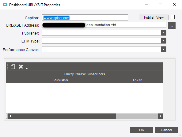

2- Add an URL View to your dashboard
3- Select the file you created earlier in the URL textbox
4- Place the View somewhere in the dashboard. The file content appears in the view
The Pros :
  • You can edit the word file and the view content will be updated
  • You can display pictures
  • It is kind of fun, which doesn’t happens often with Epicor
