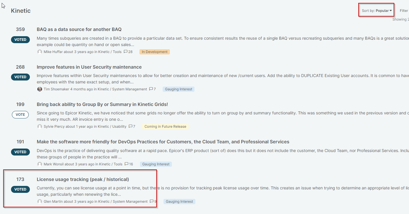

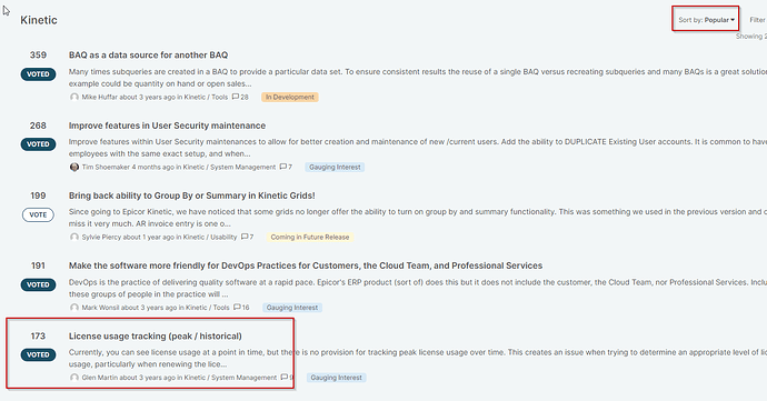

Vote! Epicor Kinetic Ideas
Epicor just made a huge deal of patting themselves on the back for releasing the most-voted for idea on the ideas portal (BAQ reference to another BAQ) in 2023.2. This one about license tracking is right up there in the top 5. If we keep voting for it it would be hypocritical for them not to build it.
In the meantime, you can buy menu usage tracker if you want to audit per screen (not per module).
The irritating thing is that you have to buy it from CSG and pay a whole separate invoice for it.

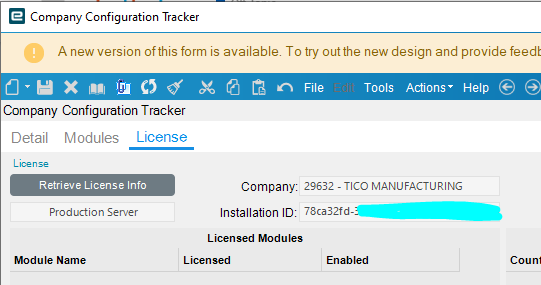

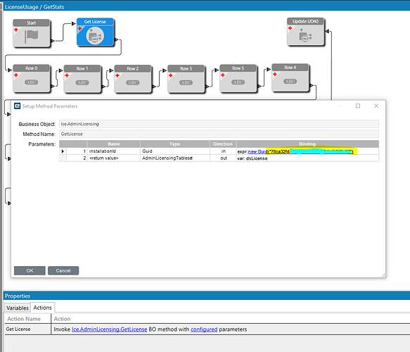

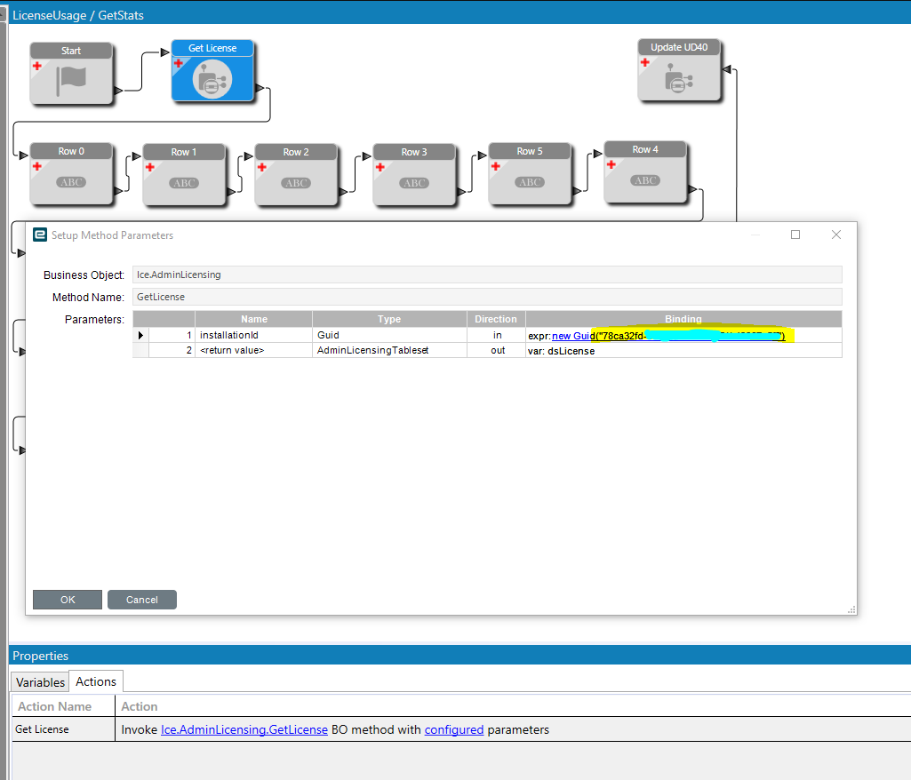

So, here it is anyway. It’s ugly. It works. I would do it differently today.
Really, all I need is for it to record the max users per hour per license type, overwriting when there is a new winner.
But when I made this, I had no idea what the data would look like. And as it turns out, when it grabs the license data, it sometimes jumbles the order of them. So I made the BAQ to decode it all.
The one oddity here is that I apparently pass in a GUID at the start. I built this off of a trace of the button in Company Config Tracker, so I guess it need that.

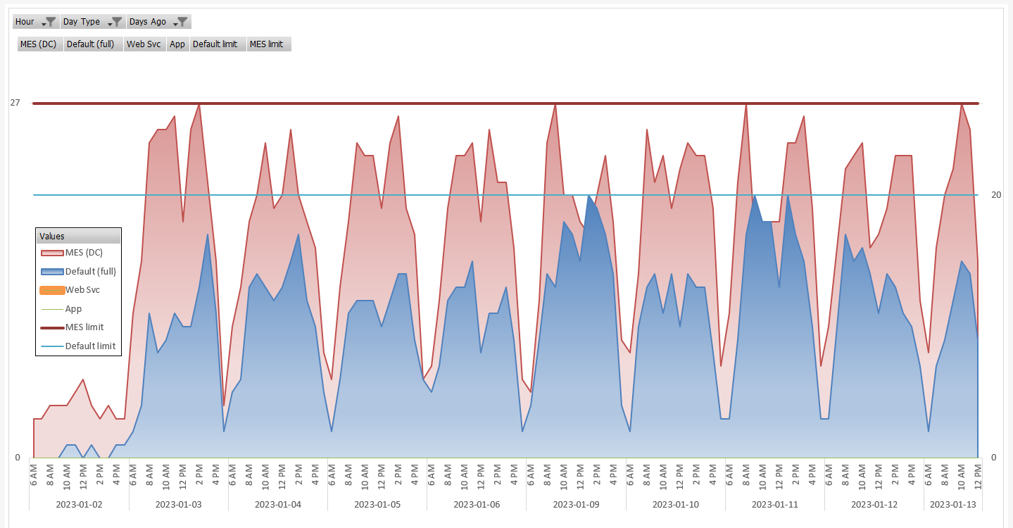

And then graph it:
Also, that UD table gets mighty full after a few months. If I only needed 24 rows a day, it wouldn’t be so bad. Another reason for a redesign.
