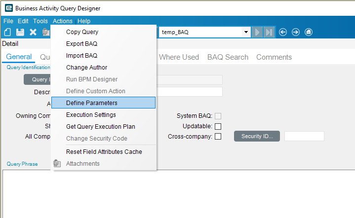

I had a good look at the BAQ Designer again and the DataSet and had a few ideas.
“Define Parameters” was out. I couldn’t take it over with code, or with BPMs, it’s
not customizable at all, and some other issues.

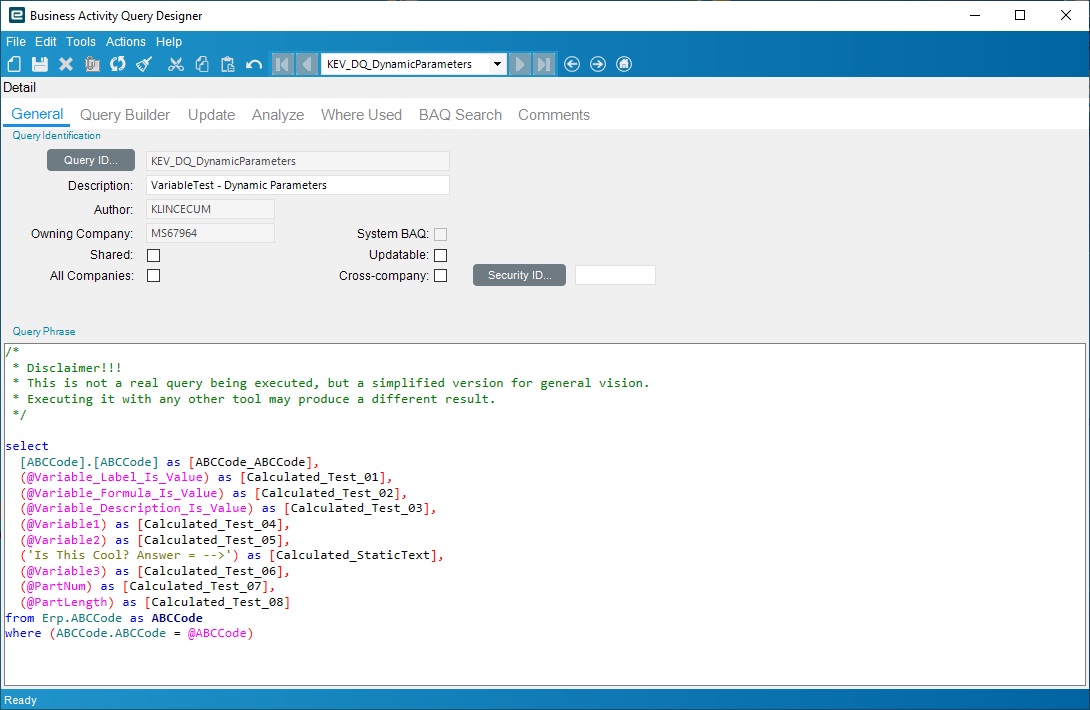

The place to do this code was the DynamicQuery BO. So I worked up version one with my rules in mind.
First I set up a test query, with variables defined in Calculated Fields, and referenced in the regular top query.
(Variables.Calculated_FieldName would be referenced as a parameter in the rest of the BAQ
as “@FieldName”)
Of course it didn’t work. Errors everywhere.
Then I started writing a pre-processing directive on DynamicQuery.GetList.
First check, does this DataSet have a subquery in it called “Variables”?
  • Nope, move along.
  • Yes?!, Ok, let the magic happen lol:
Ok, we have a Subquery named variables, now I looped through each field defined, and added the correct data to the datasets to make it work.
Time for truth.

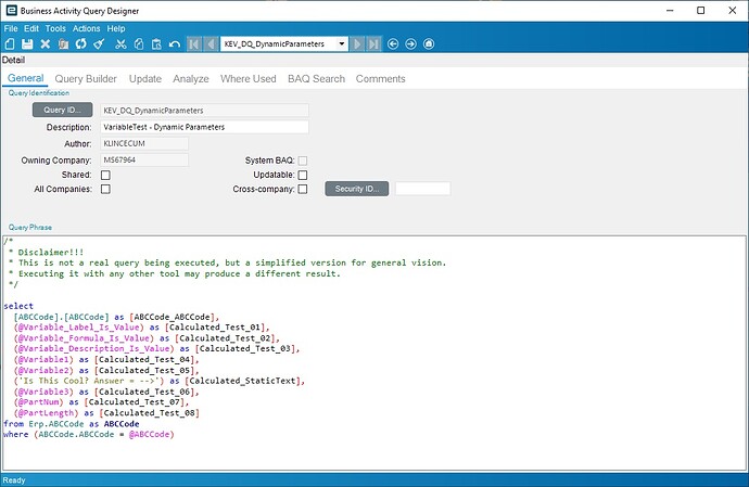

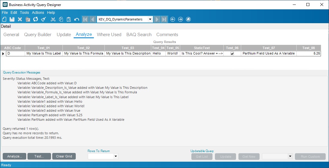

I hit “Test” on the BAQ Analyze tab, and BAM! My test query returned my variable values. It was a little messy,
but it worked!
Of course, the “Analyze” button did not. So I copied the code over unchanged to the “Analyze” method.
Syntax OK :rofl:

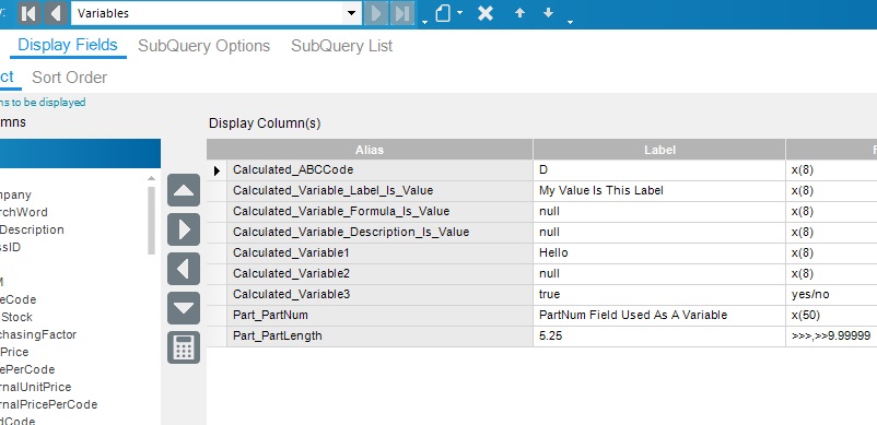

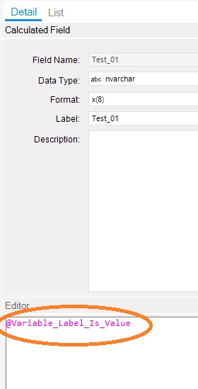

Variables (Dynamic Parameters) are defined by simply adding a SubQuery To A BAQ
with the name “Variables”
Then, you have a few options to add variables.

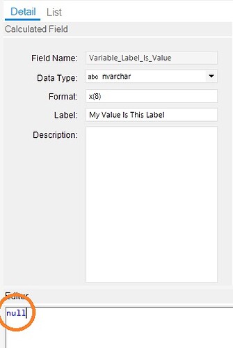

Method 1:
* Simply Add a Calculated Field, and use the label caption, as the value.
* Example → Field: Calculated_VariableTest, Label Caption: “Hello World”
* Note: I would just set the “Formula” field here to “null”, no quotes
* You would use this as @VariableTest everywhere else in your BAQ.
* This has a limit of 50 Characters.
* DataTypes are defined in the Calculated Field Editor.
Method 2:

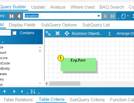

* As a convenience feature, you can add Tables to your “Variables” SubQuery
* These are added just to “steal” the names of these fields
* Example → Field: Part_Partnum, Label Caption: “I reused this field name lol”
* You would use this as @Partnum everywhere else in your BAQ.
* DataTypes is the same as the DataType of the field you referenced.
BAQVariablesQueryWithPartTableForReuseFieldNames

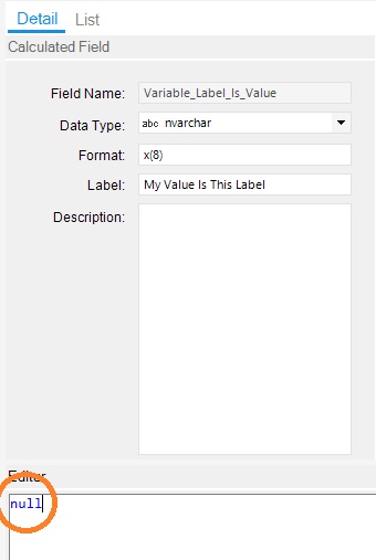

Then, you have the Expanded methods. These are built off of Method 1.

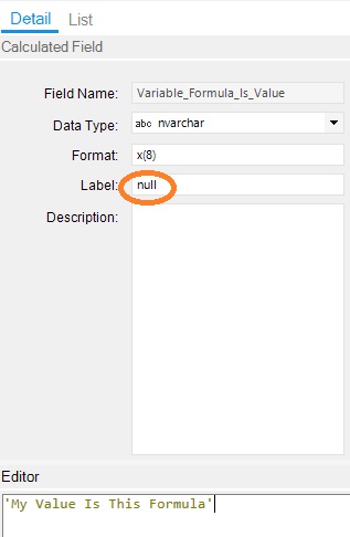

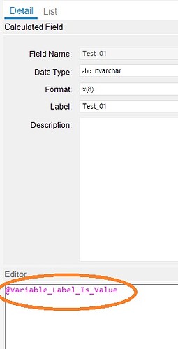

Method 1 A:
* Simply Add a Calculated Field, set the label caption variable to “null” (literally, the text “null”, no quotes)
* Example → Field: Calculated_VariableTest, Label Caption: “null” (no quotes)
* You would define your variable value in the “Formula” Field in the Calculated Field Editor
* This does not have the 50 character limitation.
FormulaIsValue

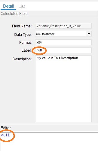

Method 1 B:

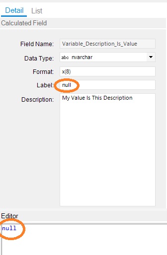

* Then set the “Formula” field to “null”, no quotes
* Example → Field: Calculated_VariableTest, Label Caption: “null” (no quotes), Formula Field: “null” (no quotes)
* You would define your variable value in the “Description” Field in the Calculated Field Editor
* Note: Due to a bug in the BAQ Designer, sometimes you will need to exit out of the Calculated Field Editor
* and save and put your data in the Description field to get it to stick. It’s annoying.

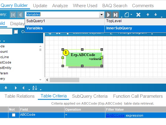

How to Use
In your BAQ, you would use these variables, just like you would use parameters in your BAQ.
Even in links, criteria, etc.
Note: In links and criteria, you would choose “Expression”, instead of “Parameter”
Just pop your parameter in the expression box, as the designer doesn’t know about dynamic parameters.
BAQSubQueryListWithCriteriaExpressionAtBottom

      try
          //You have the option on Calculated Field Variables to use the FieldLabel Field, the Formula Field, Or the Description Field --> User Preference
          //The decision tree is as follows:
          //    FieldLabel Field not set to "null" (literal string) --> Use the FieldLabel Field as the Variable Value. (Limit 50 Characters)
          //        FieldLabel Field set to "null" (literal string) --> Use the Formula Field as the Variable Value.
          //            Formula Field set to null (real null in BAQ Designer) --> Use the Desciption Field as the Variable Value.
          //                Descrition Field set to "null" (literal string) --> Set the value as null (empty)
          string parameterValue = ""; //Null or Empty Value
          if(fieldRow.IsCalculated == true) //Variable is a Calculated Field
              do
                  //If the Field Label is not null (literally string "null" here), then use it as value for the variable
                  if(fieldRow.FieldLabel.ToLower() != "null") { parameterValue = fieldRow.FieldLabel; break; } //Exit Loop When Done
                  //If the Formula Field is not null (literally string "null" here) (real null in BAQ Designer), then use it as value for the variable
                  if(fieldRow.Formula.ToLower()    != "null") { parameterValue = fieldRow.Formula;    break; } //Exit Loop When Done
                  if(fieldRow.Description.ToLower() != "null" && !String.IsNullOrEmpty(fieldRow.Description) ) { parameterValue = fieldRow.Description;    break; } //Exit Loop When Done
                  //parameterValue = ""; //Null Or Empty When Declared
              while (false); //Just for "if" short-circuit (exiting early from if not allowed, but can exit from loop with "break")
          //You can also add a Database Table to your "Variables" SubQuery. This is very convenient if you would like Pre-Made Variable Names.
          //There are Limitations to this however. You must use the Field Label for you Variable Values, which limits you to 50 Characters.
          if(fieldRow.IsCalculated == false) //Variable is a Database Field Added For Convenient Variable Naming. There are limitations.
              if(fieldRow.FieldLabel.ToLower() != "null") parameterValue = fieldRow.FieldLabel;
          executionParameterTable.Add(
              new ExecutionParameterRow()
                  ParameterID    = fieldRow.FieldName,
                  ParameterValue = parameterValue.TrimStart('\'').TrimEnd('\''),

          //Find "Variables" SubQuery In DynamicQueryTableset
          Guid variablesSubQueryGuid = (from QuerySubQueryRow subQ in queryDS.QuerySubQuery
                                      where
                                          subQ.Name.ToLower() == "variables"
                                      select
                                          subQ.SubQueryID).First();
          //Get List of all fields from "Variables" SubQuery
          List<QueryFieldRow> variablesFieldList = (from QueryFieldRow qfRow in queryDS.QueryField
                                                      where
                                                          qfRow.SubQueryID == variablesSubQueryGuid
                                                      select
                                                          qfRow).ToList();

                  //Status Messages
                  functionStatusMessages.Add($"Variable: {fldRow.FieldName} added with Value: {paramValue}");
          //Query Control Sequence is changed, Reorder
          ResequenceControlTable(queryDS.QueryCtrl);

I’ll also include an Example BAQ, that has everything set up so y’all can test.

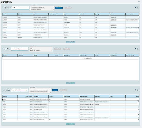

I’m going to have to read it again tonight to follow what you are doing, but it sounds like a solution to eactly the issue I was hoping to solve:

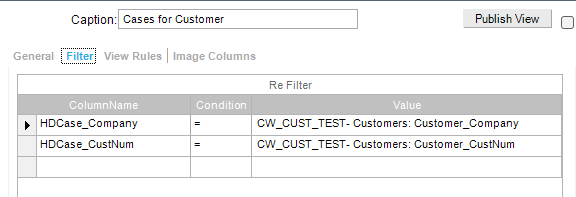

A 3 level dashboard, customer, projects and cases:
Projects are to be filtered by selected customer, cases either by selected customer or project. I’ve got over 20,000 cases so was concerned about speed if the case BAQ downloaded all the cases then filtered out for display what it needed.
I’m a bit of a newbie so thought “simple, use a BAQ parameter to pass the selected customer or project as the parameter”. Tried it and of course every time I select a customer in my top grid I get asked to again select a customer interactively; not what I had intended.
As it is currently the dash is a little sluggish, and I’ve decided to limit my BAQ to the top 5000 most recent cases for performance reasons. I expect If I can cut off the unwanted cases at the BAQ level things should hum, and it looks like this might be the answer.

It’s actually pretty simple, most of the code is just putting it all the common places, and
their associated differences, and some status features, and to make entering variables as
painless as possible.

yes; I am just wanting the case BAQ to filter at the query level to cases for the selected customer.

Currently I have this structure, to which I’d like to maybe add customer contacts also, if it can be done effifciently:
(machines are projects to us)
So here the Cases for Customer and Cases for Machine are currently filtering (cases for customer):
I am assuming this is inefficient with the grid level filtering, unless epicor is clever enough to pass the filter up.
But then I’m also wondering at which point all these views actually get populated. Do they all get loaded whether visible or not? I am creating a Kinetic app at the end of the day so only one is visible at a time, selected by the View combo.
(All Cases can probably get dumped and go into its own, separate be-slow-if-you-like dashboard)
Anyway, assuming epicor isn’t super smart with passing the grid filters up to the baq query level automatically, I thought I’d put an afterRowChanged event my customer views, and in that populate a parameter/variable in the cases query from there (similarly for machines) that would rerun the query, and i’d then get rid of my redundant grid filtering.

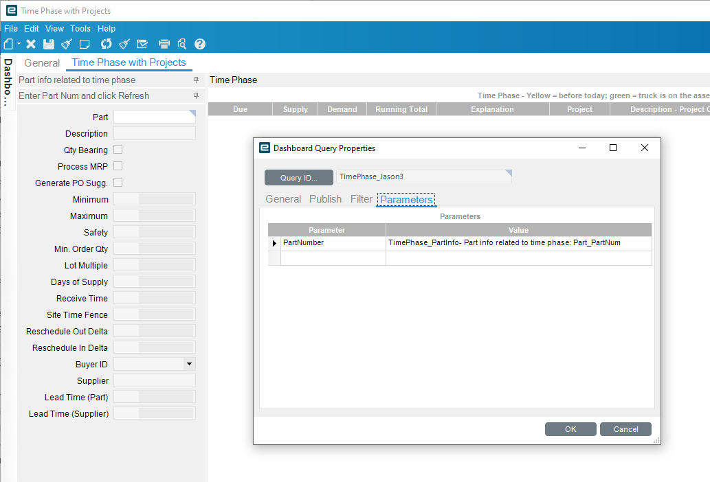

Parameters are built in to BAQs:
And they work great in (classic) dashboards:
But variables… don’t really exist in Epicor as @klincecum said.
