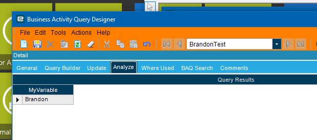

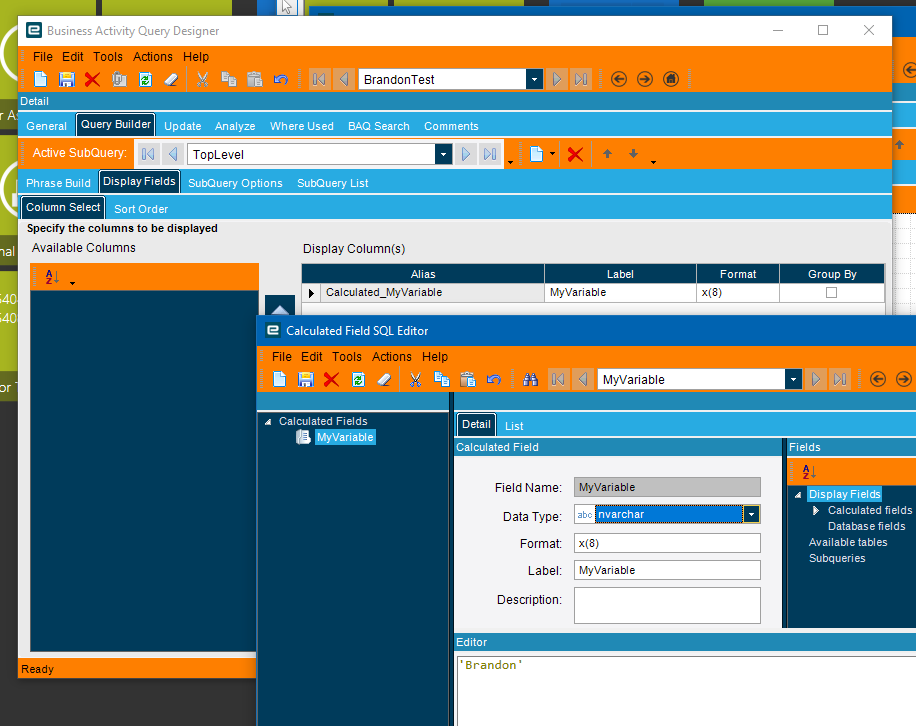

You don’t even need to bring a table. Just make a calculated field, fill in a value, and you will get one row.

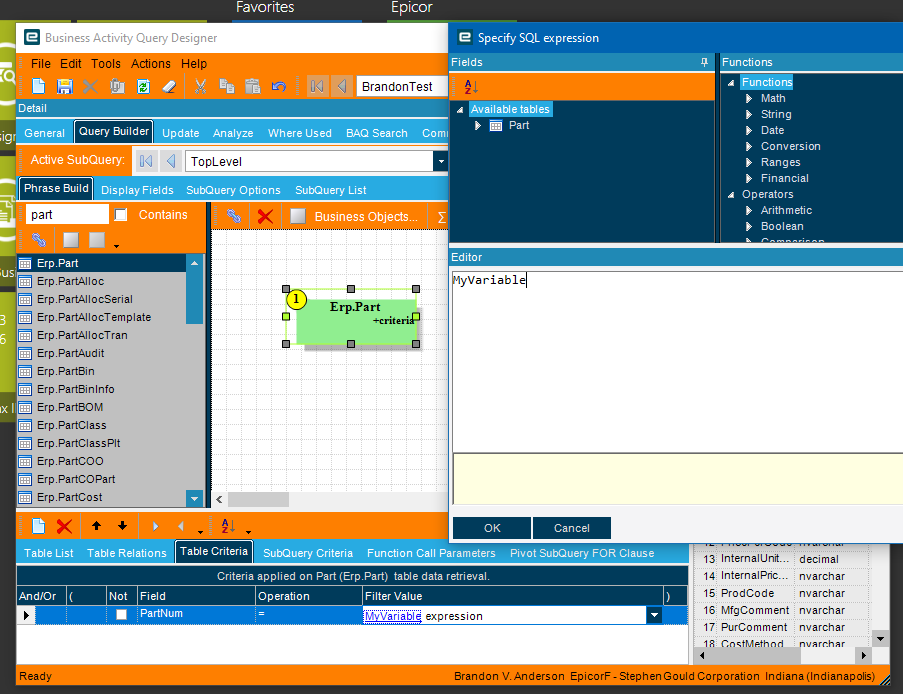

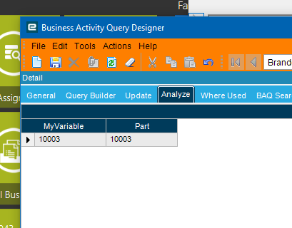

Then you can do this.
(I changed the variable to a valid part number)
@Banderson What am I looking at in this post? Is there a subquery I am not seeing?
I just used a single level for an example, but no reason you couldn’t make it a subquery. Or even just leave the calculated field in your top level. You’ll just have an extra column. You can ignore that.
