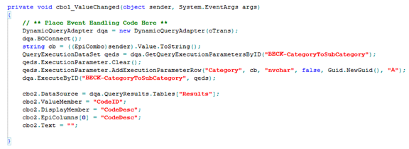

Hello Jose,
Excellent video. I think I am 90% of the way there. I am populating an epiCombo with user codes based on the ValueChanged event from another epiCombo. Here is what I have come up with based on the code from Jose’s video:

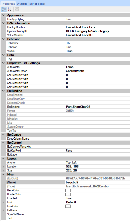

The second epiCombo is populating with the correct list from the BAQ. One issue is that it is showing every column in the BAQ and I only want to show the CodeDesc column.Here are the epiCombo properties:
The other issue is when I choose something from the list I get the following error:
Thanks for the help.

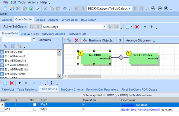

By BAQ Markup are you referring to adding Where myField = [EpiBinding: Part.ShortChar07] as a criteria in the BAQ? Part.ShortChar07 is the field that Combo1 is bound to.
I removed Combo2 and added a BAQ Combo.
[cid:image002.png@01D2AEE7.B7FA2C70]
That does not work. If I substitute in the BAQ Where myField = grp11 for Where myField = [EpiBinding: Part.ShortChar07] then it works for the grp11 code. So what am I missing with the EpiBinding?
Bill
The criteria should be set in the BAQ is that where you are setting it?
Yes. When I set it like this the BAQ Combo does not populate.
Got it! I had a space in the BAQ criteria after EpiBinding:
