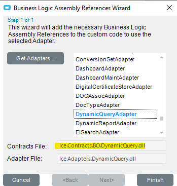

I made sure to add the “DynamicQueryAdapter” assembly reference was added per the video:
but I still appear to be missing something.

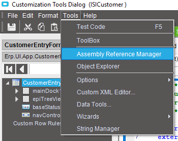

Can you look in the Assembly Reference Manager and verify that these two files actually show up?
Also try saving, then exit the customization and go back in.
I can’t remember if it was with this adapter, but I’ve seen it not compile, but saving, closing, and re-opening it seemed to clear up whatever was wrong.

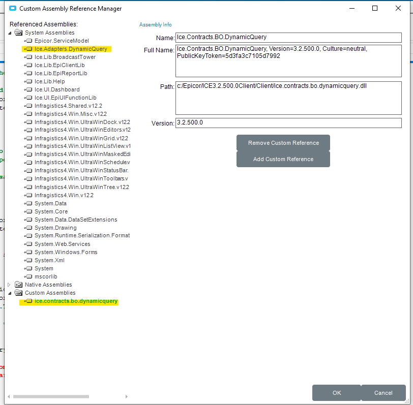

Absolutely - sorry I should have included screenshots in my initial description
EDIT: Posted this before I saw your second recommendation. Unfortunately, it doesn’t look saving and relaunching resolved it either:
That should be qeds.ExecutionParameter.AddExecutionParameterRow(“company”, company, “nvarchar”,false, Guid.NewGuid(), “A”);
Same thing for your other parameter.
