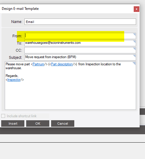

I was wondering if anyone has problem sending emails using BPM
I can send sales acknowledgements and other report via email but doesn’t work from within BPM
any advice would be appreciated
