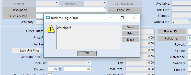

I’m not sure how the BPM raise Exception works because when I choose severity to Warning it stops the BO logic(won’t let me continue where I left off). Maybe I’m missing something? any ideas will be appreciated.

An exception is an exception the only thing that severity type controls is the icon.
If you want a warning use the display message instead
