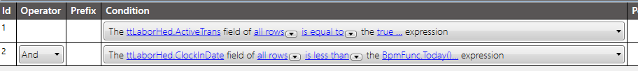

I created a post-processing BPM directive which is intended to produce a warning message on login in MES and it is acting like the setting is “error”. I want to notify the person logging in that they forgot to logout the previous day if when they first login they are still active and the clockin date is yesterday. The message encourages them to inform mgmt to correct time and to clockout. By setting it as “informational” or “warning” it SHOULD process forward and open the MES buttons (Clock Out being the most important) but it doesn’t and nothing opens up just as you would expect with a “error” setting. Is this a bug, “as intended” or am I spinning around in the ozone? Any help, hints, tips or suggestions is much appreciated. I’m sure I’m not the first person to try to address issues with failure to clock out (lol).

Ok, nominate me for the next Darwin Award prize. Yeah, that’s the fix. Knew it had to be “user malfunction”. THANKS!
