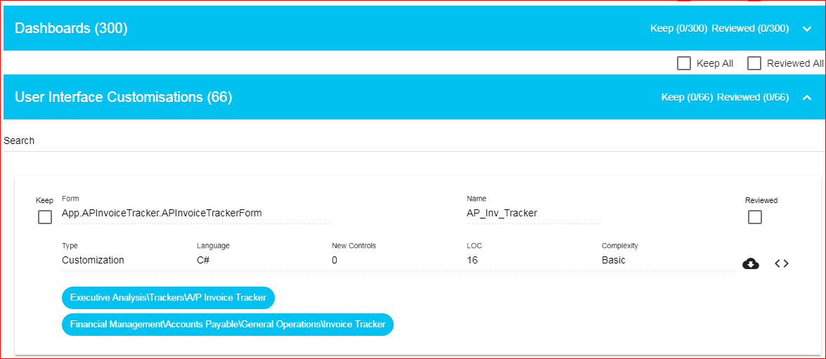

You can’t beat the price, now in terms of using Epicor for uplifting the customizations, reports, bpms etc that’s a different bear. I recommend doing that in-house if you have the expertise, nobody knows your business better than you and with 10 the odds are you probably won’t need a lot of those old BPMs and such.
Don’t underestimate the no longer need. Spend your time doing the gap analysis between old version and new and the intent of the BPM / customization. It’s amazing how much lint you pick up in software over years of use that no longer apply or are now in the new version.
FYI - I just described every product I have worked with for the last 30+ years. That’s one consistent aspect of software and business - change.
