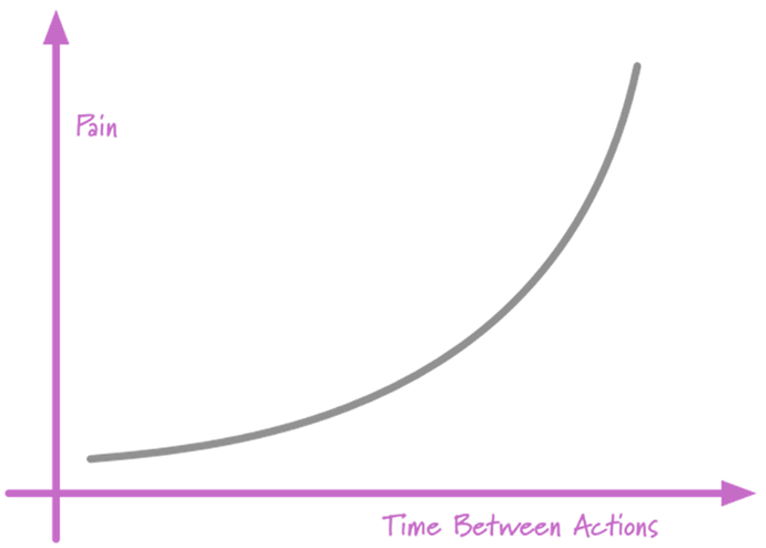

If you get too far behind it will just get harder. If you keep up to date regularly, it wont be so much work up front.

Another question to ask: “Is there a way we can be more efficient as a company with our ERP system?” In the past, we’ve made these “Pets” of our ERP systems. We’ve created hundreds of reports (which nobody uses or forgets why they were written or the person who asked for them is gone or…) and we’ve locked in a certain process which prevents our company from adapting to new realities. So one of the biggest improvements to staying current isn’t in the software but your enterprise. Companies are moving away from reports (a nice 70s technology) and moving towards things like Epicor Data Discovery - which is basically dashboards on steroids. This reduces reporting requirements for IT and empowers the users.
I get it. Management, hell - everybody, wants stability and dislikes change. But our business environments are changing faster and faster. Planting a flag on a particular version of software feels like the right thing but the longer we put it off, the harder it is to adapt - as you’ve seen. The more often you do something, the better you get because you really are challenged to remove the wasteful methods or at least reduce the time to do so.
We’ve gone from 10.0.700 to 10.2.100 to 10.2.200 to 10.2.300 in the last 18 months. This has gone remarkable well. First, the changes are smaller so the effort is smaller. Second, people are used to testing and test better than they do when they do it every 3 years.
Reducing unnecessary modifications or making smarter alterations to the software not only saves time but gives you the ability to save money too. Management is getting tired of spending thousands of dollars on hardware upgrades. “Didn’t we just buy you new servers ten years ago?!” :neutral_face: Staying current allows you to easily move to a private or public cloud if/when the costs work for you.
But most importantly, staying current (not just jumping to the latest version and sitting there) frees up some imagination to let us control our processes and not let our system built on aging assumptions hold us back. At least for us, sitting on an old version? #NotToday.

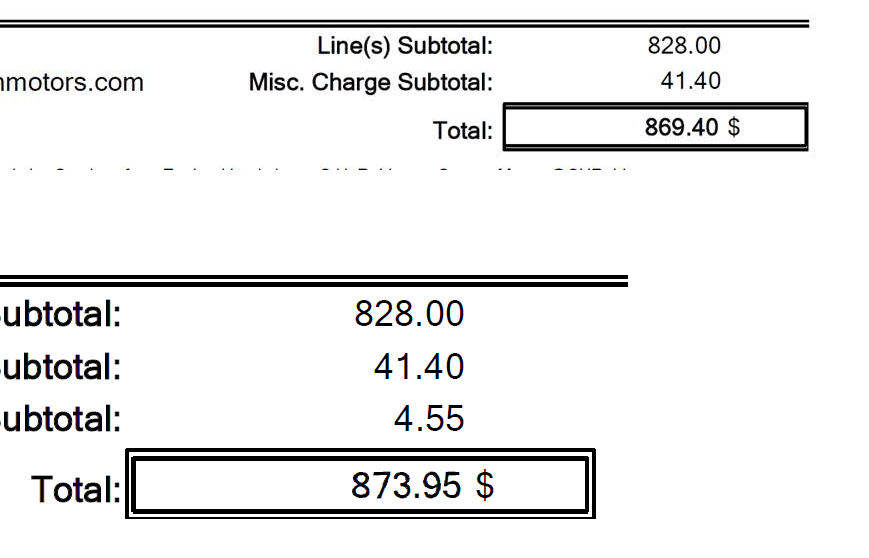

For us the main reason is MRP and Finance which have its problems and those problems are actively being addressed on 10.2.
Also Reports have fixes, for example Sales Order Acknowledgement in 10.2 now includes the Tax in the Total, well when we sell a 1 million $ item and tax it 10K and then send the Customer a SO Acknowledgement without the Tax (in 10.1.500 it didnt SUM it in), they will be surprised when they get the invoice which will be a discrepancy vs the SO Ack. For us a SO Ack is a Legal Contract.
PS: The Tax is also missing on PO Report and Quote Form
10.1 vs 10.2
Also 10.2 runs on Entity Framework 6 while 10.1 is on EF4, funny thing I just sent this Email out this morning:
@ERPSysAdmin PS: The Tax is also missing on PO Report and Quote Form in < 10.2 - Many Companies are leaving Money on the table and not realizing it, its not easy to spot :slight_smile:
POForm 10.1.500 vs 10.2.300.13
