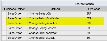

For example, CheckSellingQty vs. CheckSellingQtyMaster seems like the later is the only way to have Epicor report back to be a problem with a counter sale that the line item is out of stock (negInvTest) – but unsure. That’s important because you can’t sell something that is out of stock at the time of a “point of sale at the counter” order – eg. there’s nothing to put in the bag.

ChangeSellingQtyMaster has a boolean parameter “negInvTest”. When I call the method and pass a true value, I never get any response values of a problem.
Following the trace log further, I call ValidateInvQty which also does not return any messaging (all empty strings).
