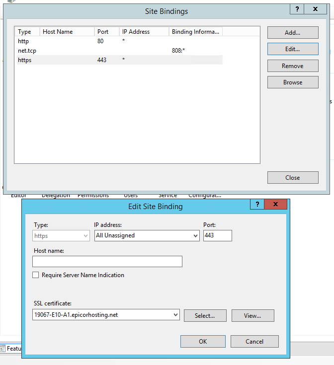

So you have some setup work to do first… Check out Bart’s REST Novella thread. Lot’s of info there as most of it was written during 10.1.500.
Well, I got it to work till http://servername/ERP101500, but when I add the /api gives me the error, HTTP Error 404.0 Not Found
Did you see @Olga’s message?
Yes, I did. Makes sense. To be honest, I am not sure what to look for in the Web.config.
Fixed! Got it working. I rebuild the appserver and that fixed it!
