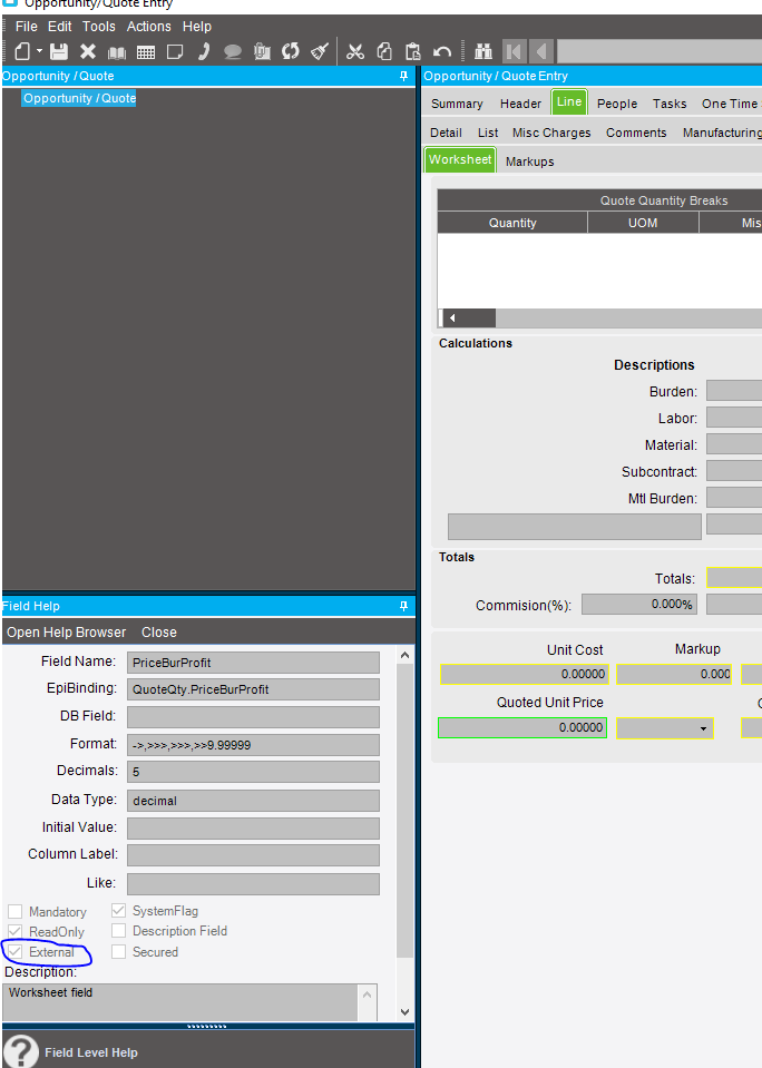

Here is what I meant by External field (see picture). I dont know if it is a field that is either calculated in real time or is saved in another table, but i couldn’t find it in the database. In this case it is supposed to be in the QuoteQty table but there are no fields called PriceBurProfit.
It’s probably calculated by the business object and doesn’t exist in the DB. There is often a field that is very close in the DB. I would find the relevant calculation in based on the other fields. There is also the chance that it’s a patch field. They were very common in E9, but not as common in E10. The patch fields are stored in a table named something like Ice.PatchField.

I checked Ice.PatchFld and looks like there are only 13 fields in here.
