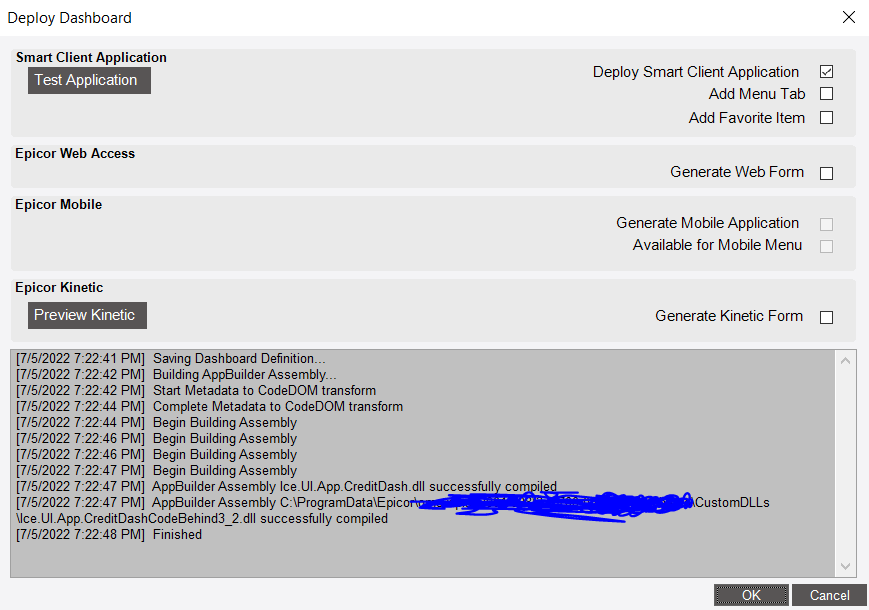

However, my issue is that now the deployed version of the NEW dashboard does not allow the “Updatable” prompted fields to be updated. It shows them in GREY instead of the usual WHITE for the updatable prompted fields.
What is even stranger, the new copy of the updatable dashboard appears to work perfectly fine in the “Test Application” version, but not in the actual deployed version on the menus.
Here is what the fields looks like in the “Test Application” version which allows update (white, updatable):
Here is what the fields look like in the actual deployed version on the menus (greyed out, not updatable):

I appreciate your responses a lot. Clearing client cache and re-deploying from the app server with Manager credentials was one of the first things I tried but to no avail. I just tried once more to make sure-- no dice.
Deployment process appears to complete successfully, but the finished product is not the same as the “Test Application” version from the deployment window. The only difference remains that the updatable fields set to Prompt still show greyed out when accessed in the deployed version from the menus.
