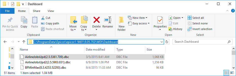

I may be WAAAAY off here because I don’t deal a lot with Dashboard creation and deployment but whenever we’ve had problems with a Dashboard not opening for a user, or not updating with changes, we would go into the C:\ProgramData\Epicor\epicor1-9401\9.05.702\WDI\Dashboard folder on the server, or user’s PC with the issue, and rename\delete the .dbc file (I believe this is safe to do as I think this is only a temp file that gets regenerated every time a Dashboard is opened). This always seemed to work for us in our E9.05.702 - Progress - environment not sure if that Dashboard folder even exists anymore in an ERP10.1 SQL environment?
