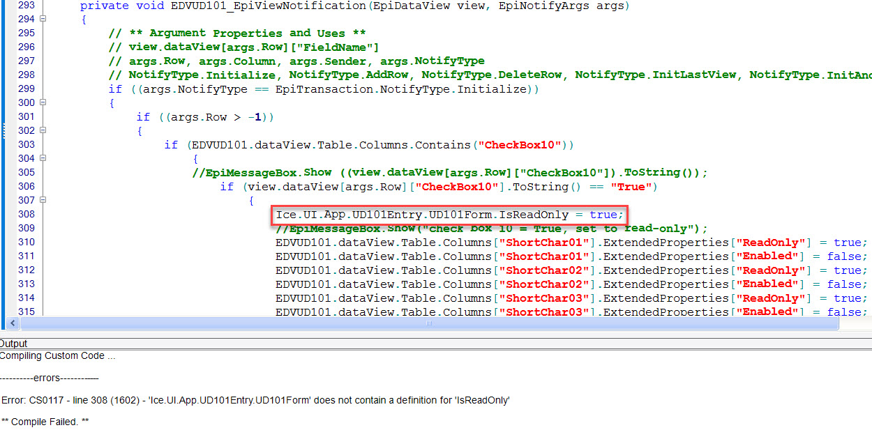

There is a IsReadOnly flag on the Form level. Just set that to true, and change it on AfterGetNew back to False.
Thank you for the response, but how do I use it? According to the “Object Explorer” there is no form read-only property.

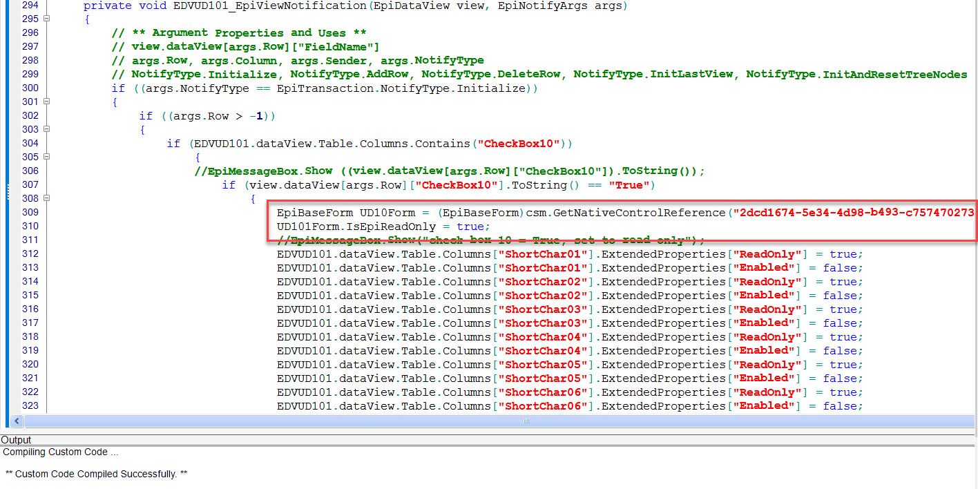

Based on the value of CheckBox, I am using the Extended Properties to mark every control on the form as read-only. This does works, but very cumbersome.
UD101Form.IsEpiReadyOnly = true;
Jose. That worked perfectly!..Seriously, how do you know these things?! (when there is no documentation about this anywhere).
In any case, it doing what I needed now…

One comment here that is not that important but you shouldn’t have to use csm.GetNativeControl reference you should have a local instance of the form available at the customization level by just referencing the form
UD101Form.IsEpiReadOnly for what it’s worth
