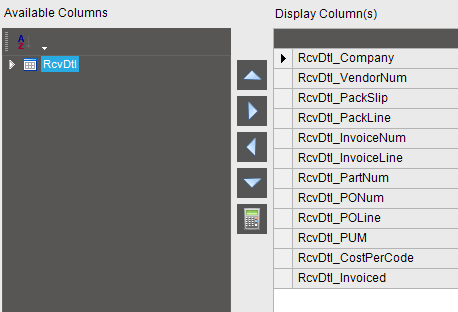

I created a BAQ for my datalink to validate things, although this wasn’t necessary. As a result of how the LineItemsPO table gets populated in the PNP workflow, the records will match up organically because they are all from the same table, as far as I am aware. What isn’t part of this, for whatever reason, is the converted factor.

It’s more directly related to this specific portion of the workflow, rather than a general statement, as this section of the workflow is interacting with the receipts for a PO. In order for the lines to be pulled into ECM, they would logically have to come from the Rcv_Dtl table as that is where this is information is stored in Epicor. This is only an estimate, though, because we unfortunately cannot actually verify how the integrated datalinks have been developed. With that being said, if you test them in the Admin panel you can at least see the results and with the method I developed for this I have never seen an issue in matching records.

I suppose it doesn’t exactly “know” so much as I am telling it what it should be. Since I am pulling the CostPerCode from the same table that the receipt lines are coming from, the order is also the same; that’s why the Set Field Group task works as both the CostPerCode and the LineItemsPO table are in the same order. It’s definitely not a science, it’s more of an art… and I am no artist lol
