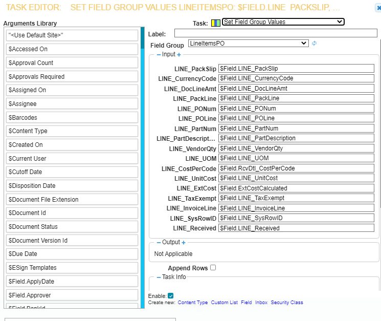

Yes, the CostPerCode is part of the LineItemsPO field group, but I also have this populating a Rcv field group I created with just this single value from the datalink. I am using the Advanced Math task to create a calculated ExtCost with the following formula:
Input {0} = LINE_VendorQty
Input {1} = LINE_UnitCost
Input {2} = Rcv_CostPerCode (This is just where I stored it, but you will have to reference where you have this stored in the field group you created for it
Output = ExtCostCalculated
IIF(‘{2}’=‘M’,({0}/1000){1},IIF(‘{2}’=‘C’,({0}/100){1},{0}*{1}))
After this task I set the field group for LineItemsPO and where the ExtCost field is I used my new calculated value of ExtCostCalculated.

  2. Advanced Math task as explained above to create the ExtCostCalculated field
  3. Set Field Group task to set the LineItemsPO table with all of the usual values except I replace the ExtCost with the ExtCostCalculated amount calculated in Step2; I also add the CostPerCode into the LineItemsPO table by populating that field with the Rcv_CostPerCode field, but this isn’t exactly necessary

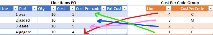

When you do a set field group task, how are you ensuring the right lines are getting the right cost per code?
For example, if I have two field groups, one for LineItemsPO and one for CostPerCode like below… How are you doing a lookup/join to get the corresponding codes associated with eachother?
In the case of the PNP workflow, the LineItemsPO table gets populated with the lines in the order that they are in on the Receipt Entry. As such, the CostPerCode will also be in that order. In your screenshots the lines may be displayed out of order, but the “Line” field is a match as you have displayed with the arrows. To use your example, this would allow you to set the "Line Items PO field group with the “Cost Per Code Group” values, where applicable.

Still not getting it Victor… set the Line Items PO field group with what task?
You can use the Set Field Group task to set all of the LineItemsPO fields. For the CostPerCode field you have created in the LineItemsPO field group you would enter the field value from your CostPerCode field group.
