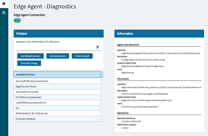

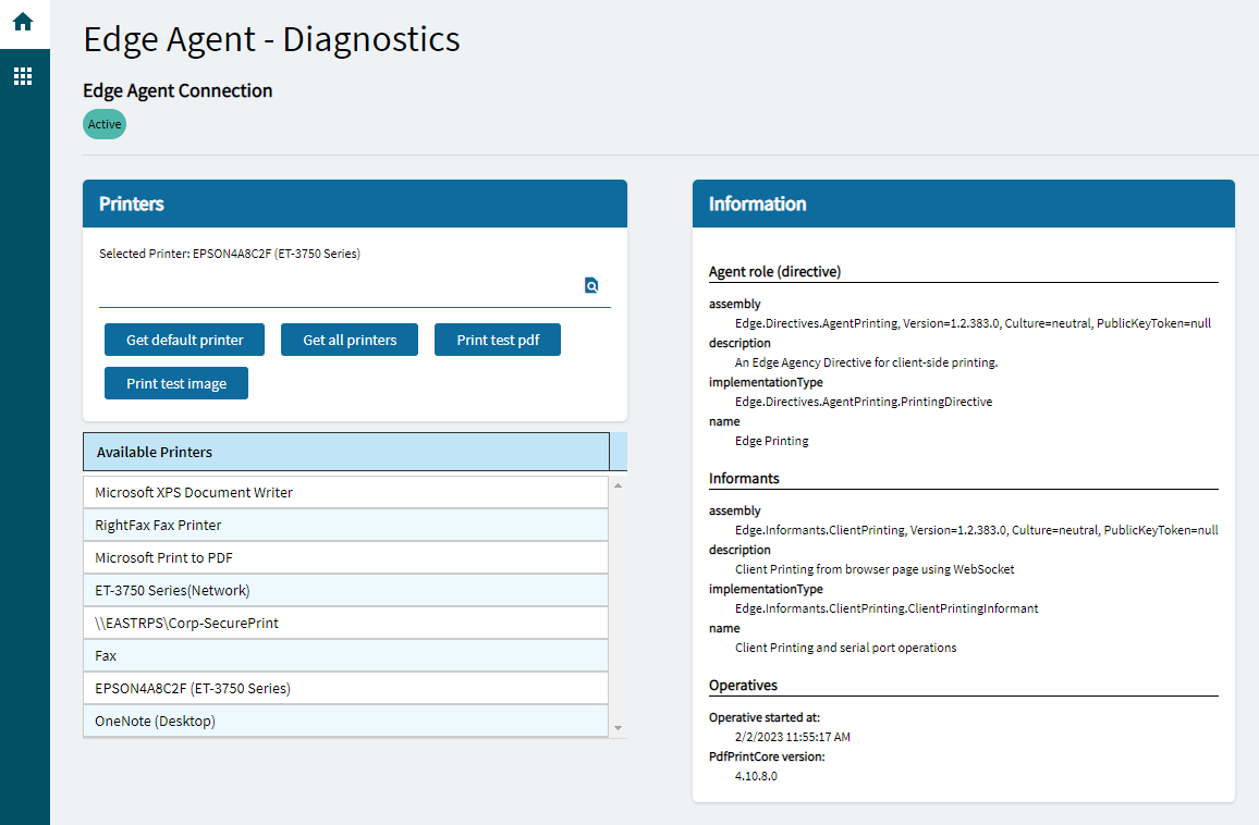

Edge Agent Diagnostics Page and Testing
Once you have the Edge Agent Installed and Running you can do some testing and playing with it by visiting
https://localhost:6071/#/home
This will show you the Edge Agent current status and allow you to play a bit with it and make sure it is functioning appropriately

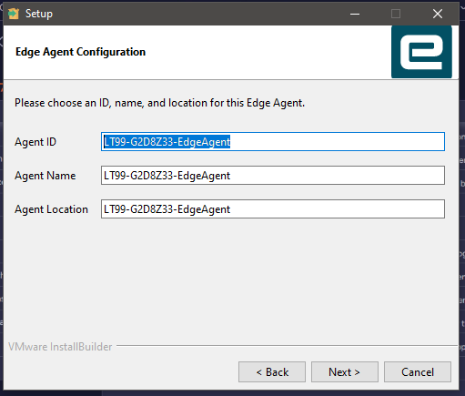

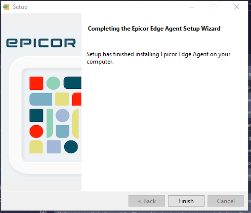

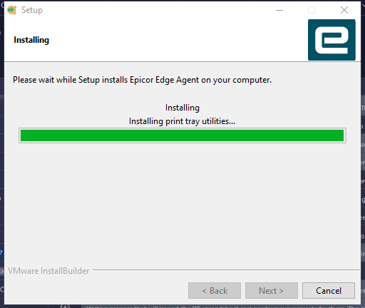

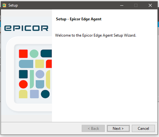

  1. Run through the Installer (as shown below)

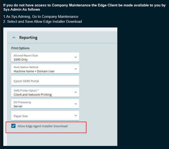

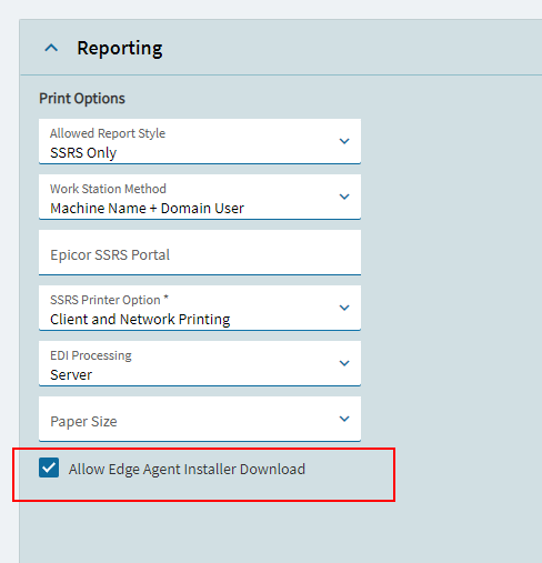

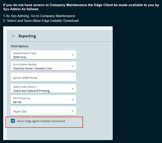

If you do not have access to Company Maintenance the Edge Client be made available to you by Sys Admin As follows
1.As Sys Adming, Go to Company Maintenance
2. Select and Save Allow Edge Installer Download

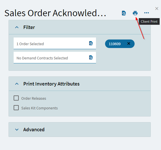

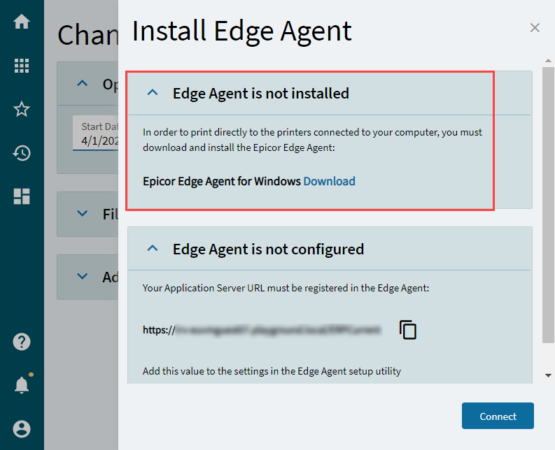

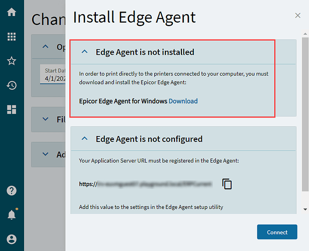

Then as a user when you go to Print for the first time the Edge Agent will be offered to you when you click Client Print in Epicor Kinetic.
  1. Click Donwload

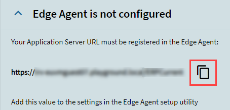

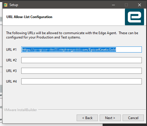

  2. Copy the application server URL to your clipboard, you will need it during installation:

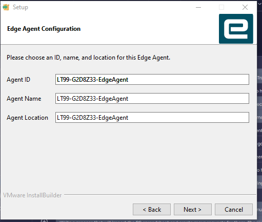

  3. Follow the Installer Prompt as Shown
Installer Prompts
Paste the URL you copied earlier into this screen, you can provide up to 4 different App Servers which can use the Edge Agent.

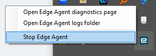

Once Everything is installed you will a couple of new Icons on your System Tray
Epicor Edge Agent where you can see the logs and the Diagnostics Page
Epicor Print Tray where you can see some advanced options for printing

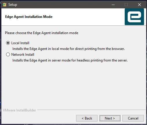

What about the Network Install side of it?

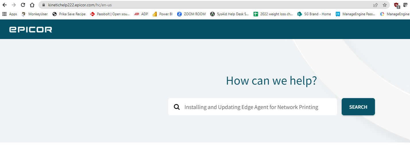

Same principle except it lets you print directly yo server side printers in a “headless” mode. That setup is a little more complicated there’s instructions to do that in Kinetic Help but it can only be accessed within Kinetic. Allows you to print to corporate / network shared printers etc.
Search Term:
URL (once you click through kinetic the first time)
https://kinetichelp222.epicor.com/hc/en-us/articles/9682820222861-Installing-and-Updating-Edge-Agent-for-Network-Printing
I don’t have time right now to outline it in detail if someone has access to a Kinetic Help page maybe you can add those instructions here :slight_smile:
Network will work with SaaS license only
Correct. And you can have both installed in your environment. One Network Install for network printing and the client install on local computers. Additionally, you need to have the Network Install option installed to be able to add printers in Epicor.

@Erin_Corona you do not need to install it yourself for each computer, just enable allowing edge agent download then your users will be prompted to install it

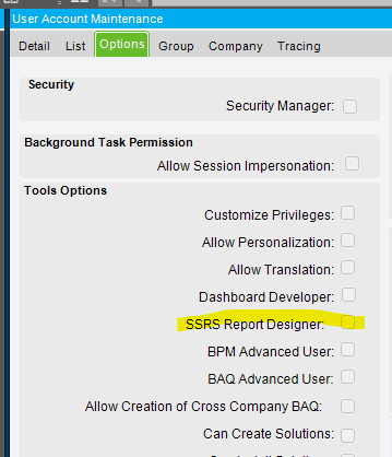

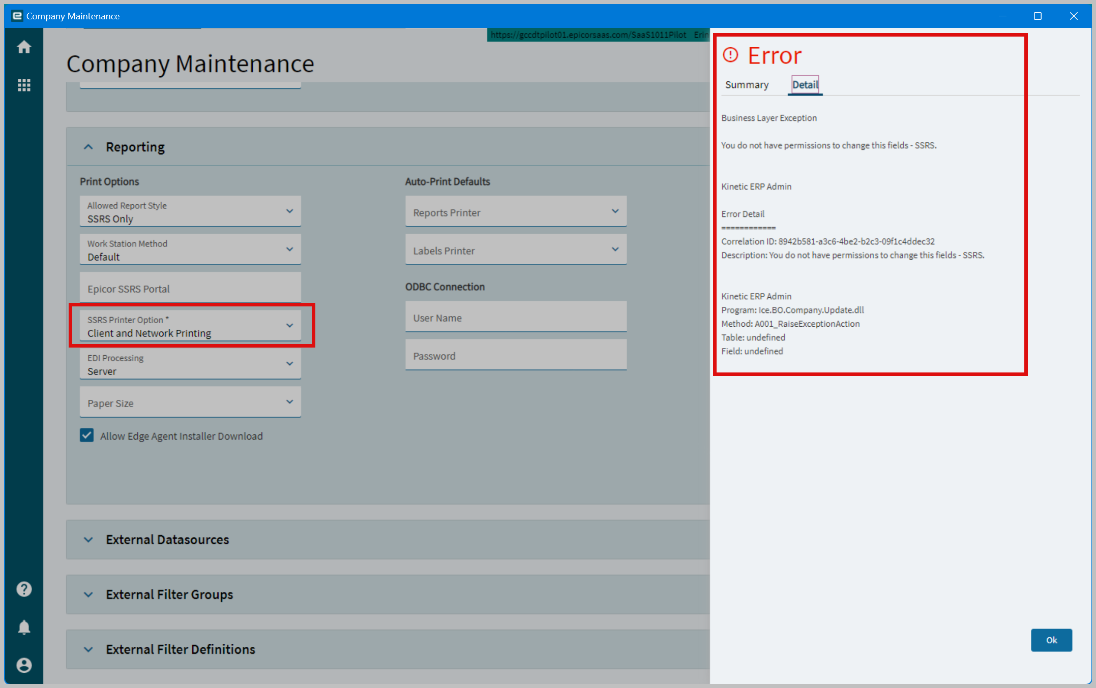

Your screenshot sparked another question I’ve had, and I wonder if you know the answer. On Company Maintenance on the same screen as you’ve shown, in the SSRS Printer Option field we show “Client Printing Only” and if I attempt to change it to Client and Network Printing I’m met with the following error:
I’m a system admin, but I logged on with the manager user ID to try again, but same error. That made me think we don’t have the option to change since we’re cloud-based, but I would think that network printing would be allowed, so I don’t know. I do have a ticket in with Epicor, just waiting on their response which I pray comes before the EOD.

Make sure the user account you are using to change this has SSRS rights, only thing I can think of
@Erin_Corona , it is probably because you are MT SaaS. They lock down a lot of that stuff for MT.

I’m able to set up Network Printers and select them in the Kinetic UI, but when I attempt to print to one of the network printers I get a PRINTER NOT FOUND error for all of them. I’m hoping I just had the url wrong, or something relatively simple that can be corrected now…I hate not knowing what to expect.
You’re probably right. Watch - Epicor will respond back saying Network Printing does not work yet for ML Tenants and I’d have spent my whole day trying to “fix” it…I sincerely hope that is not the case.

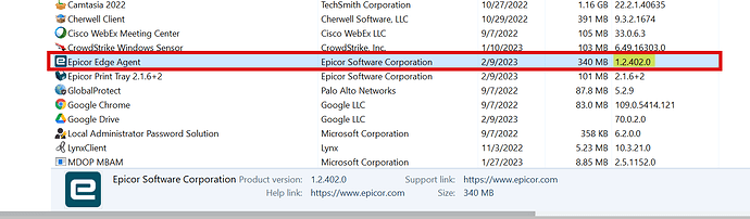

Per the Epicor rep on my case, the notification that went out was only intended for users who had already been using the Edge Agent and won’t impact business for anyone else.

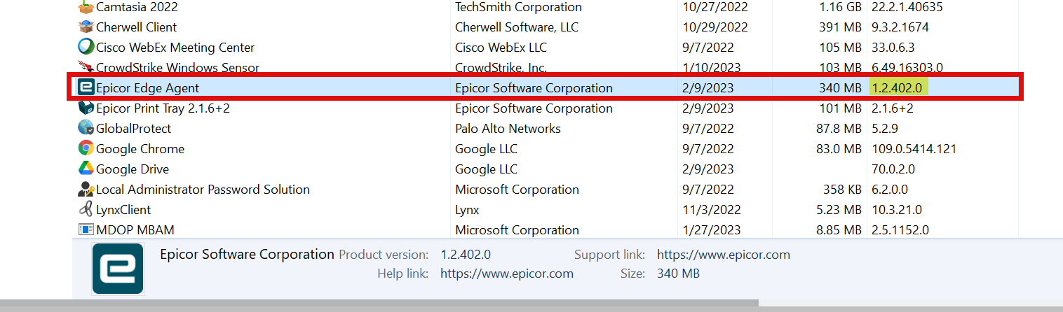

If you’re unsure, open Control Panel - you’re looking for the Epicor Edge Agent with the version number shown. If it’s a lower version number, then you need to update. If you don’t see it at all then you don’t use it so you don’t need to update:
We did not have it installed until I installed it this morning. If you were confused as well, it could be that you have a similar scenario: I knew I had seen “Network Printers” before in the system in the past and I assumed we were using it. (I think I’m remembering from Epicor 9 though.) When I opened Print Management there were two printers already set up as Network Printers. Our issue was that we had not enabled Network Printing since we upgraded, which was why they didn’t work, even though they appear in the dropdowns as options. (Names/IPs were from when we were at a different address so they also had to be changed.) So in this case, I really didn’t need to do anything for this update, since nobody has been able to use network printers anyway.
I had to verify, after @Mark_Wonsil 's comments above - ML Tenants can use Network printing however you need to have Cloud Support enable it for you, which is why I was unable to change my own settings here:
My support ticket was put in earlier today to enable Client and Network Printing in Pilot and Live, and once it’s enabled, I’ll update with anything else I have to do to get it working but it seems pretty straightforward from here. It’s possible I just missed that part in all the documentation, but did anyone see it documented that for MT customers, a request must be put in to the Cloud Team? I’d like to make sure I get that document for future reference. This was an entire day of reading and testing that could have been avoided if I’d found the right document, and I feel like an idiot. (Hope my mgr doesn’t read this. :grimacing:)
