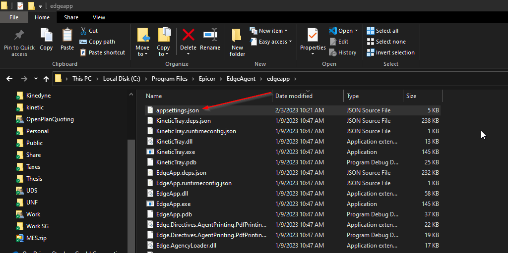

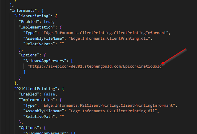

What about adding or updating the Allowed URLs?
Like adding Test & Pilot environments after the initial install?
Or when switching servers?
So far the only way I could work out how to do this is to rerun the installer (if you still have it since if the Web Client detects the Edge Agent, no matter the environment access it does not provide the download again)
CAVEAT: I’m Making some assumptions that it will work if you change / add to that array.

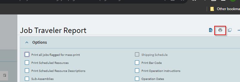

Installed edge agent but client print not active. Any idea why?
Did you install it as Network or Client version?
