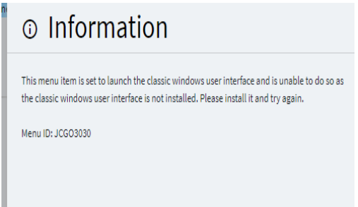

When they try and launch an application that is using classic they get this message:
So it seems to be installing the edge agent but maybe it is not linking to the path to the client??

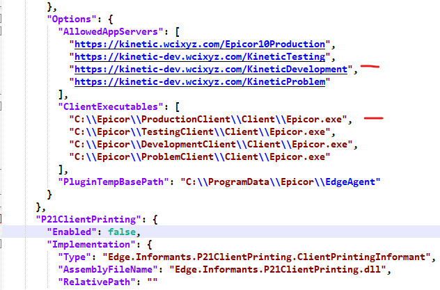

I ran your file and I see the value in the “C:\Program Files\Epicor\EdgeAgent\edgeapp\appsettings.json”
      "ClientExecutables": [
        "C:\\Epicor\\ERP11.2.400.4Client\\Client\\Epicor.exe"
So it looks like the value is filled in as expected.

Update: It is mandatory for the client to be installed and ran first to let it compile and auto update. Then you can install the edge agent and runs perfectly!

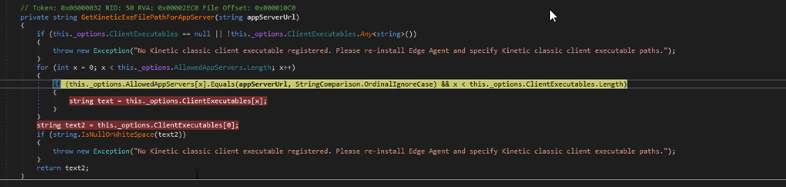

Hey @Olga looks like there is a bug. Took us a while @josecgomez and @jgiese.wci to narrow down.
We are in KineticDevelopment and it doesnt pick the right Client.
Notice string text inside of the for loop, gets the right value but string text2 outside of the loop just goes back to index 0.
You know how to report bugs, right? :laughing:
It is not here.
I did not look in this code myself.
Automated System Message: User hkeric.wci token has expired and is unable to read posts for 48 hours.
We’re setting context so when support tells us it’s not a bug… :wink:
Case CS0004201576 for reference LOL :smiley:
I neither confirm nor deny this is a bug :smiling_imp:
I am always confused if it should be a Ticket or an Idea. That’s all… Its easier to tag Olga and @JeffLeBert for them to atleast confirm its a bug, before I lose my soul going through Tier 1, Tier 2, Problem, Ah Its Not a Bug. :smiley:
