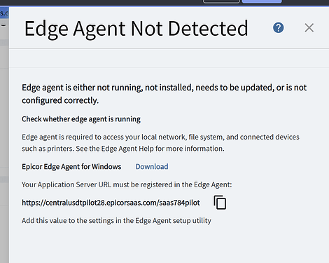

I have been working in many SaaS environments now, and have now tripped across this on Time and Expense.
It won’t let me go any further - anyone else run into this?
Have tried loading the Edge agent -
Odd thing is that I have been able to do quote to cash with no issues.
Just can’t modify a labot record.
It’s probably trying to open a Classic version of the Time and Expense entry from the browser. Since the release of 2023.2 version the browser is able to open a seperate version of the Kinetic client for a particular screen, in this case Time and Expense entry. Once you’ve set up the Edge Agent for your environment, Kinetic browser will open Time and Expense in the Kinetic client with the Classic version of the program.
