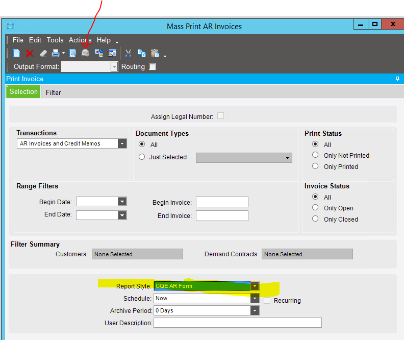

Email a report
Is there any way in 10.1.400 to make available the “envelope” to send email when using a custom form in crystal report?
No that feature is only available in SSRS.
