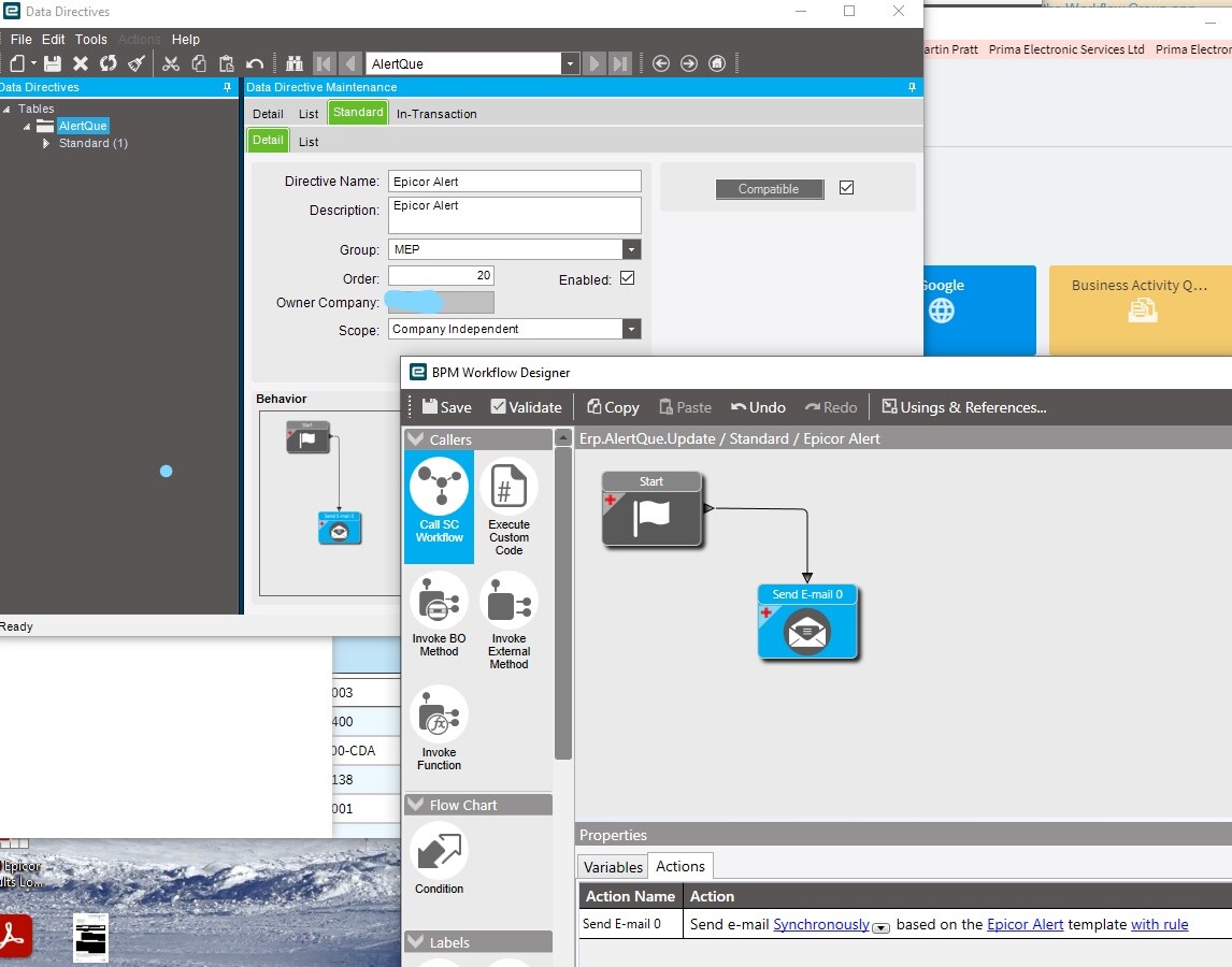

I do have a BPM. The Global alert is enabled and is sending alerts to the alert queue. The BPM is picking them up and sending the emails.

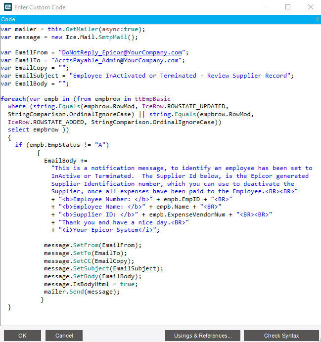

I use a Data Directive to create specific email messages within Epicor to be distributed. I began using the Global Alerts, but found I could not always have the email contain the information I needed to convey.
For example, I have an email that is distributed to our A/P team, when an employee is InActivated or Terminated, as A/P needs to InActivate the Supplier record so the ex-employee does not accidentally get paid for expenses in the future.
The data directive checks on the Employee Status and if the EMPSTATUS field is not equal to ā€œAā€, the directive runs my custom code to create and distribute the email message. I can send a screen shot of the code to set-up the email message, if you wish.

This is a Data directive. A standard BPM on Alert.Update.

As requested, this is a screen shot of the data directive I use to create an email message:

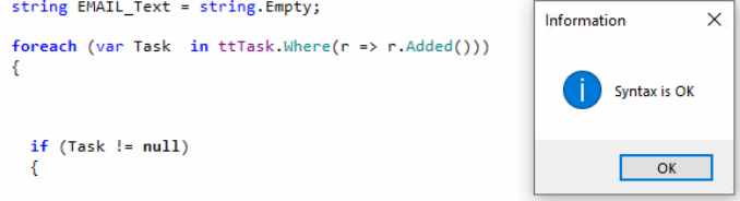

@brandtley - I assume that in the BPM workflow designer you are replacing the ā€˜send email’ with ā€˜execute custom code’?

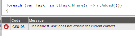

I have been looking at your code and have tweaked it to suit my needs, but I am not an expert here. I am getting an error with part of the code and am not sure how to fix it.
any ideas?
In Kinetic, tt tables were replaced with datasets.

@MEP That looks like my code and it is on a Standard Data Directive of the Task table.
@Mark_Wonsil I went to our 2021.2.10 assuming I would see that the ttTask had been changed to ds.Task as most of my routines had been converted, but it was still ttTask. :man_shrugging:

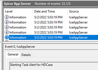

@MEP It is a place to start. The Log.WriteEntrys will write to the Appserver Event Viewer and the serverlog if you have that on. The code checks for added so you don’t need a condition.
The event viewer should at least show the starting and ending lines if the routine fired at all.

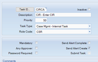

@MEP No worries this is how we learn. Does the task have send alert create checked?

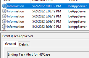

These are the event viewer lines generated if the email is sent. You should at least get Starting and Ending if it fires at all.

Yes the task has the send alert create checked
As for the event log. I had assumed I would see this in the windows event viewer, but I cannot find any mention of IceAppServer anywhere.
Am I looking in the wrong place?
