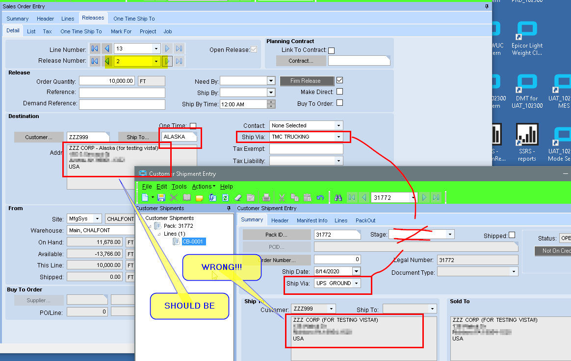

Even when I select a specific order line and release for the pack line, the packer header info still shows the Order Header info. The Ship To doesn’t even update. If one doesn’t manually change the ShipTo, the release would go to the wrong place.
Ship Via doesn’t update either.

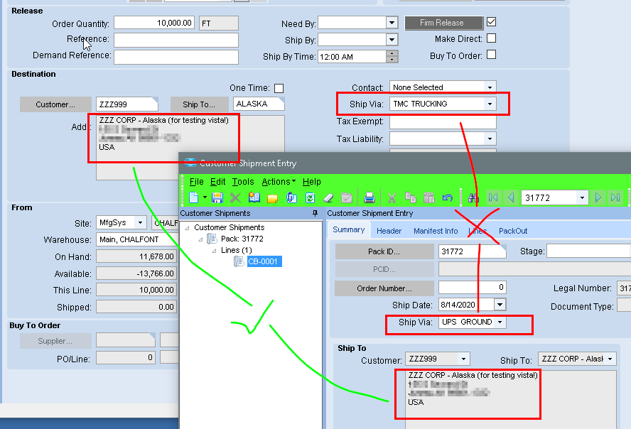

After saving, the Packer’s Header ShipTo now matches the Order Release. BUT the Ship Via’s don’t:

Possibly there is already a BPM in place then. When I create a shipment entry, the ship via matches what’s on the sales order release. It does not do this in EMW however.
Might want to look at a BPM on CustShip.GetOrderRelInfo I made a simple BPM that warns when the ShipVia of the Order Release doesn’t match the Packers ship Via.
I take it all back. I did not see any BPM’s but my main Epicor will pull the ship via from the order release. I tested this on the handheld and it seems to work fine as well… I will check with our shipping manager and figure out what the problem is then. They had claimed to have set the shipvia on hundreds of order releases and when the orders were shipped via EMW, the packing slips showed the default, not what was on the release. I’ll have to check with the shipping manager and figure out what they are talking about…
