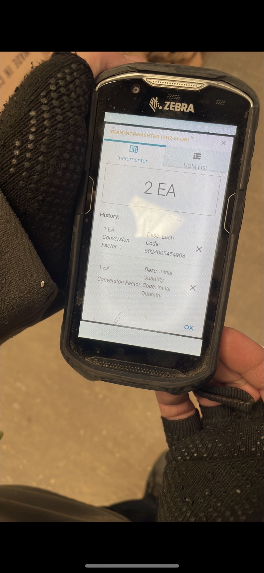

this morning there was an update on the Epicor Kinetic Warehouse app now when we scan 1 box it fills the quantity as 2 one is the barcode and one is initial quantity we then have to delete initial quantity each time to progress

No joy still dont work we have a scanner which didnt auto update and still works fine

With this setting off, the scanner Is still incrementing the qty.
It’s not clear what screen you’re experiencing this issue on, but there is also “Prevent scans changing quantity” in Settings > Receipt. Is this switched off for you as well (if the issue is related to PO Receipts)
