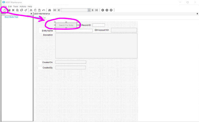

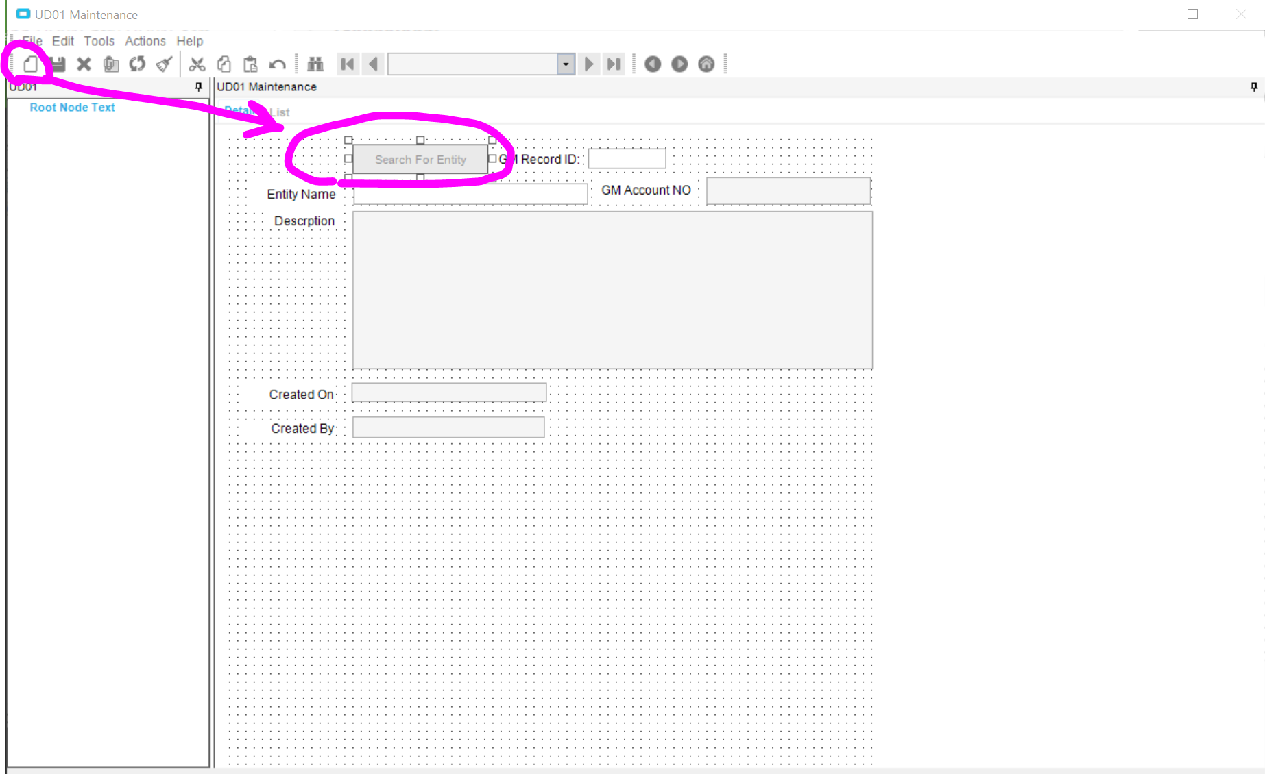

Hi Epicor Community,
I need to keep this button on the UD01 form disabled until the user clicks on “Create New” on top left.
After that I need to make the button enabled and when user clicks on the button, it will populate some fields such as “Entity Name”.
Is it possible to do something like this?
