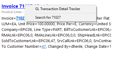

@Alexandre_Pothier I thought the user could see the data but wouldn’t be able to launch the form without the menu security? Does it ignore menu security when launching the form?
Is that the standard epicor context menu in ES?

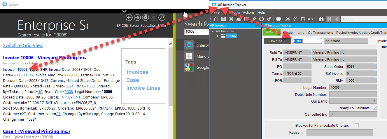

I confirm, the form is launched.
Let’s say I don’t use the context menu. If I click on the invoice number it opens the form.
About the security, it’s on the folder. It’s not viable to go through each single menu item.

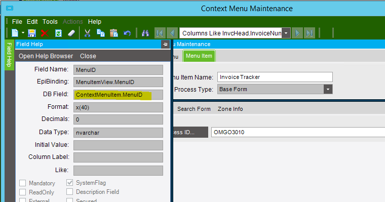

The Invoice Tracker is in various places on the menu. You need to confirm that the correct form has security access for the user. So in this example when you right click on the ES record and open up Invoice Entry. Click on Help > About > System Info. In the Software Environment tab scroll down to ProcessID. The value is what needs security access.
So in this example its OMGO3010. This is called from the Order Management > General Operations > Invoice Tracker.
So in Menu Maintenance make sure that the user doesn’t have access to this menu item.
I tested in Menu Maintenance and gave my user disallow access to OMGO3010 in the security. When I login I don’t get the option for Invoice Tracker.
@afabian Do you guys have a list of all of the Menu ID’s that are used?
It sounds like it’s using the default Context Menu record but when I look for those I’m not finding anything in our ICE.ContextMenuItem table. Even though that’s where the field help claims it is.
Its in Context Menu Maintenance (System Setup / System Maintenance) for InvcHead.InvoiceNum.

@afabian I’m just trying to get a list of all of the default context menu items.
@Alexandre_Pothier. You need to add security to the particular menu item item that Invoice Tracker is calling. It is not calling the Invoice Tracker under Financial menus but from Order Management.
@John_Mitchell I don’t understand what you mean by a list of all default context menu items. These are all in the Context Menu Maintenance by the key field. So for example it its a part, then it would be Part.PartNum, if a Sales Order, it would be OrdeHed.OrderNum, etc.
@afabian That should be saved in the DB somewhere. We should be able to query that table and return all Conext menu’s and which MenuID they are pointing to. When I look at the Field Help it is referencing the ContextMenuItem table but when I look at that table in my DB it’s empty.
@Alexandre_Pothier You should be able to change all of the Default Context Menu Process ID’s to the ones that you want and have it respect the security that you expect.
