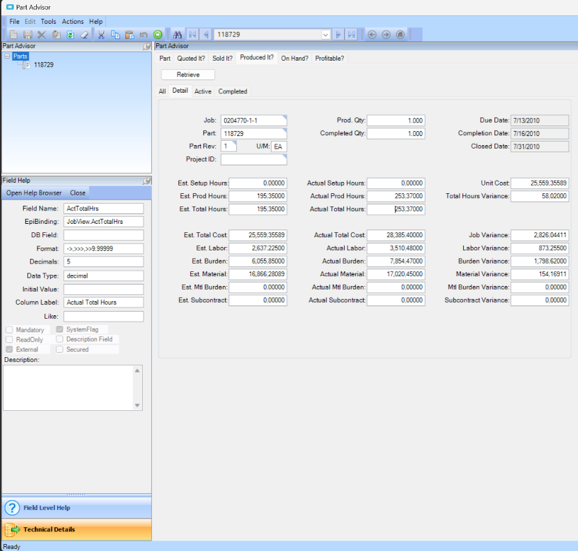

I have looked at other posts, and while they were helpful, they didn’t provide the information I am looking for. In Part Advisor, we have a bunch of boxes that have an EpiBinding to JobView.(NameOfField). I am used to looking at the Field help section to design a SQL script to pull data. JobView is not a table though. I know it is a view, but how can I make a consumable, like a BAQ or SQL script in SSMS, to view that data? Just wondering if anyone knows how to handle these specific types of data that aren’t your typical Table.Field structure.
Those are calculated fields which don’t have a correspondent in the database. You won’t find those in the DB - note that DB Field there is empty.

I think there’s a data view created along with the form. So, if you want to use them in the same form, it won’t be a problem. If you want to use them somewhere else, I don’t think it’s possible.

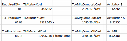

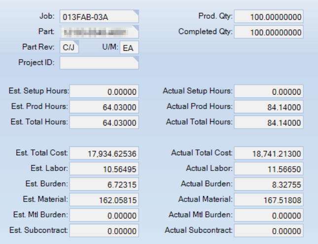

You will have to dig a little for them. I usually use Job Tracker that is at the Job Level. Part advisor adds another level of fun to get to unit costs and so does subs built in house.
TLA fields are This level Actual, TLE fields are This Level Estimates, LLA, LLE are Lower level assemblies.
